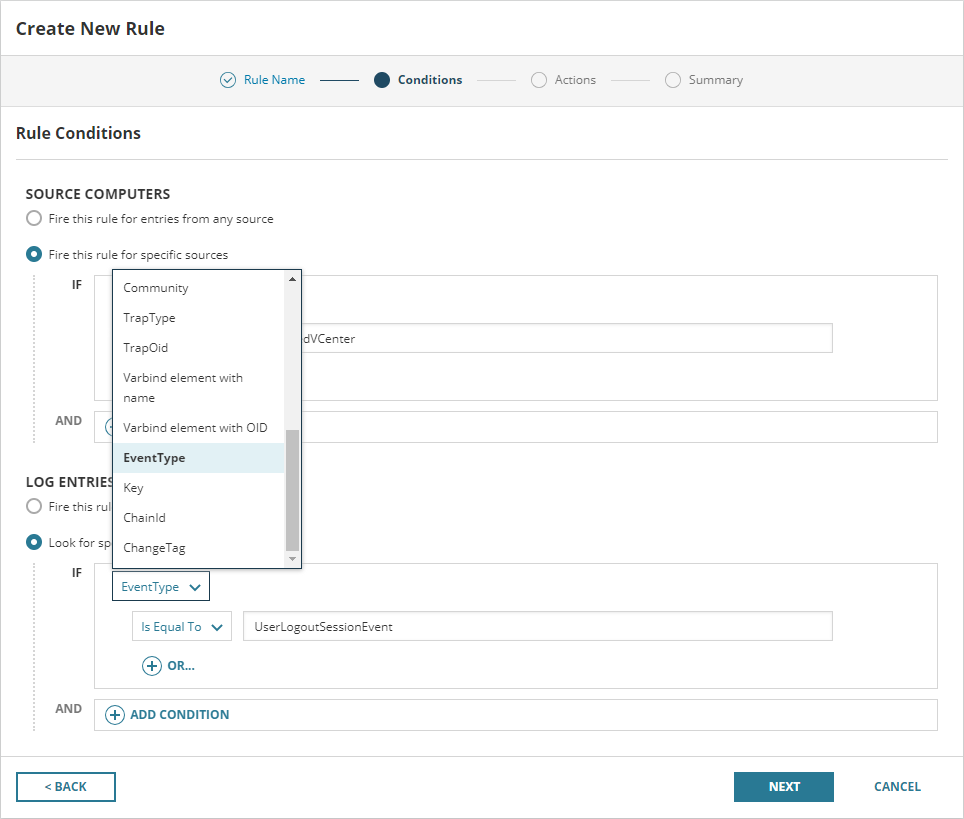

- Specify the triggering conditions.
- Set the source computers.
- Under Log Entries, select the option Look for specific entries.
- Set IF to EventType (you can also select other attributes such as User, Level, Message, SourceType, and more)
- Set Is Equal To the type of event that you'd like to trigger an alert. In this example, we'll set it to UserLogoutSessionEvent:

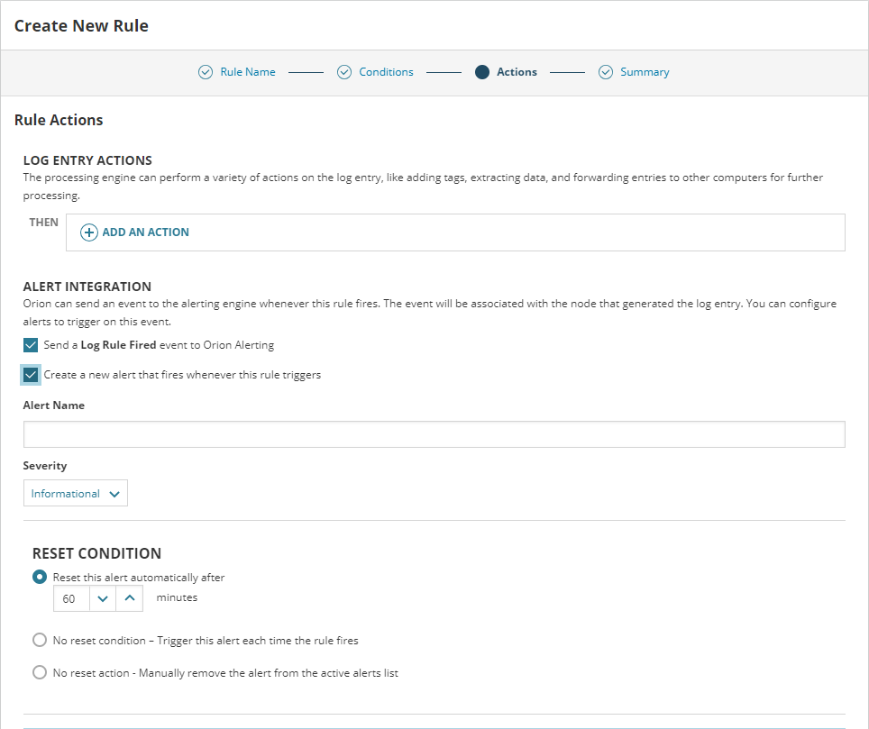

- On the Actions tab, check the box for Send a Log Rule Fired event to Orion Alerting
- Check the box for Create a new alert that fires whenever this rule triggers:
- Configure the alert by following the onscreen instructions.
- Review the rule and alert integration on the summary tab. Click Save when done.
