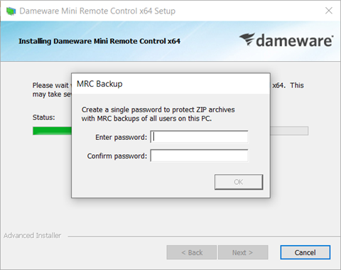

If you are upgrading from a previous version of Dameware to Dameware 12.2.2 or later versions, the following dialog prompt appears during MRC, Dameware Remote Support (DRS), or server installation:
Create a single password to protect ZIP archives with MRC backups of all users

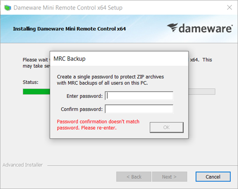

SolarWinds recommends that you create a strong password. You must then re-enter your password correctly for validation. If you do not enter it correctly in the confirmation field, you are prompted to try again.
Password confirmation doesn't match password. Please re-enter.
Passwords cannot be restored at a later point, so be sure to take note of your password in order to access the archive in the future.

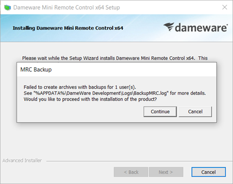

After your password is accepted, the backup creation process begins and may take some time to complete. However, in some cases, the following message may display:
Failed to create archives with backup for 1 user - Continue or cancel?
This error indicates that an error has occurred, preventing one or more backups from being created. You can see which Microsoft Windows users on your PC were affected by viewing the %APPDATA%\DameWare Development\Logs\BackupMRC.log file. You may select to continue the installation anyway or cancel it. However, if you choose to continue the installation, SolarWinds recommends that you first follow the instructions in the BackupMRC.log file to back up the Dameware MRC data of affected users manually.
