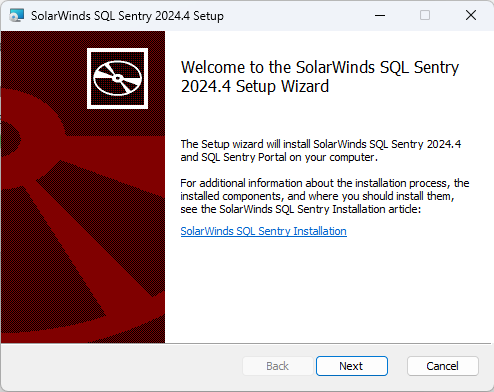

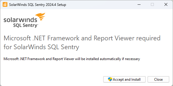

  1. Execute the SQLSentrySetup-x64.exe file. You'll need to select Accept and Install. The Microsoft .NET Framework and Report Viewer will be included with the SQL Sentry installation (if necessary).
  2. A welcome dialog displays when the SolarWinds SQL Sentry Setup program starts. Select Next to continue or Cancel to exit.

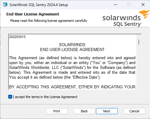

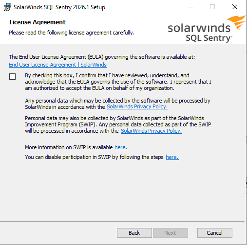

  3. Then, the End-user license Agreement dialog appears. Select the checkbox to accept the terms, then choose Next to continue.
    Note:  For future reference, a copy of the license file is located in the Client folder of the installation.

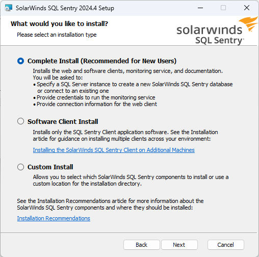

  4. On the What would you like to install? screen, choose an installation option. By default, the Complete Install option is selected (and used in this example). It installs the SQL Sentry client, SQL Sentry monitoring service, SQL Sentry Portal, and a PDF copy of the user documentation.

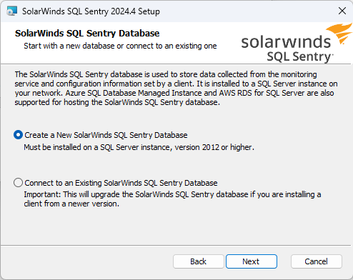

  5. On the SolarWinds SQL Sentry Database screen, choose Create a New SolarWinds SQL Sentry Database (default) or Connect to an Existing SolarWinds SQL Sentry Database.(most commonly used for an upgrade or installing an additional SQL Sentry components on other machines). This example uses Create a New SolarWinds SQL Sentry Database.

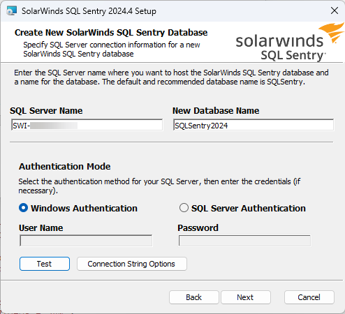

  6. On the Create New SolarWinds SQL Sentry Database screen, choose a location and name for the SQL Sentry database. Enter the server instance where you'd like to install the SQL Sentry database in SQL Server Name. Enter a name for the SQL Sentry database in Database Name. The default Database Name is SQLSentry. The SQL Sentry database is created as part of the installation process. If you're upgrading SQL Sentry, specify the name of the existing SQL Sentry database (past default SQL Sentry database names have included SentryOne). All the necessary schema changes are applied to the existing database during an upgrade.
    The Authentication Mode options available for connecting to the SQL Server that hosts the SQL Sentry database are Windows Authentication and SQL Server Authentication. If the Windows user account you're using for the installation doesn't have the required privileges on the selected SQL Server, select SQL Server Authentication and enter a SQL Server User Name and Password for an account with required SQL Server privileges. See the Monitoring Service Security article for the account's full security requirements.

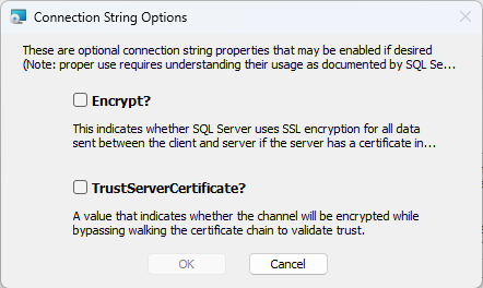

    With SQL Sentry Version 2024.3 and later, you can enable optional connection string properties Encrypt and TrustServerCertificate. Click Connection String Options to open the configuration window. Select the applicable options, and then click OK to save your selection.
    Note: Proper use of Encrypt and TrustServerCertificate requires understanding their usage as documented by SQL Server. See SQL Server support documentation.
    Example uses Windows Authentication & includes SQL Sentry Portal

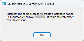

    Select Test to validate the database account information. After a successful test, select Next to continue the setup.
    After selecting Test, a popup will confirm your database selection:
    Note:  If an existing database has been chosen, selecting Test asks you to confirm that you want to upgrade the database.

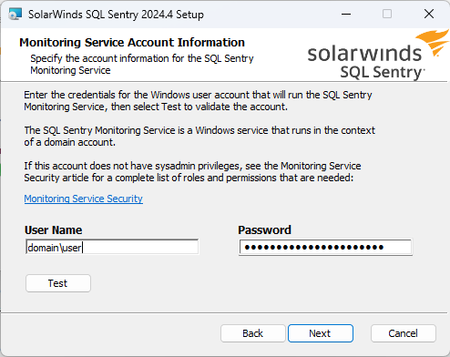

  7. If you've selected Windows Authentication for the Monitoring Service SQL Credentials, enter the Windows account User Name and Password on the Monitoring Service Account Information screen, under which the SQL Sentry monitoring service will run. Select Test to validate the chosen credentials. After a successful test, select Next to continue the setup.
    Note:  See the Monitoring Service Security article for the account's full security requirements.
    Monitoring Service Account Information and Test
    Note:  Change the service account any time after the initial installation by running the Service Configuration Utility found in the SQL Sentry program group. See the Monitoring Service Logon Account article for instructions.

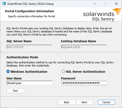

  8. On the Portal Configuration Information screen, choose an Authentication Mode for the SQL Sentry Portal service to connect to the SQL Sentry database and enter those credentials. Note:  It is necessary to enter the credentials on this screen for either authentication option. The Test will fail if the credentials are blank.
    SQL Sentry Portal Configuration Information and Test
    After selecting Test, a popup will confirm your service account validation:

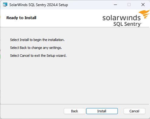

  9. On the Ready to Install screen, select Install to begin installation.

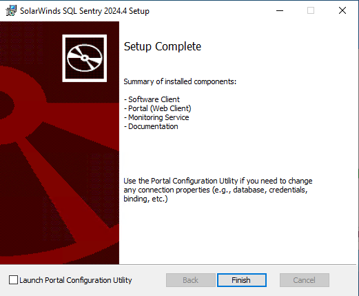

  10. Wait for the installation process to complete, then select Finish to complete setup. You can click the checkbox to launch the Portal Configuration Utility to update any settings, such as the server, database, credentials, encryption, port, or apply a certificate and use SSL.

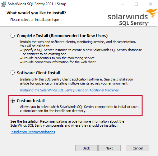

  1. On the What would you like to install? screen, choose Custom Install.

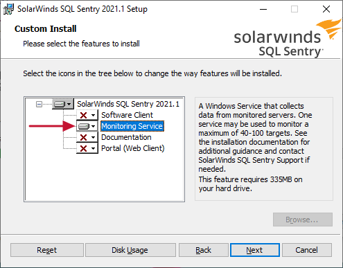

  2. To install the SQL Sentry monitoring service on a machine, select only the Monitoring Service option on the Custom Setup screen of the installation process.

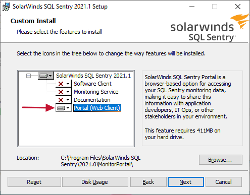

  2. On the Custom Install screen, select the drop-down arrow next to the Portal (Web Client) component. Select the Entire feature will be installed on local hard-drive option.
    SentryOne Custom Setup Monitor Portal
  3. Select Entire feature will be unavailable next to the other components if you are installing only the Portal (Web Client) service.

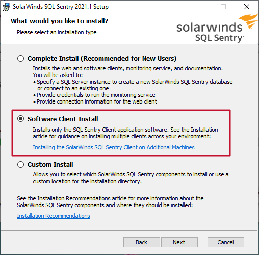

There's no need to install a monitoring service on any workstation machines. To install just the SQL Sentry Software Client do the following:
  1. On the What would you like to install? screen, choose the Software Client Install option. Select Next to continue.

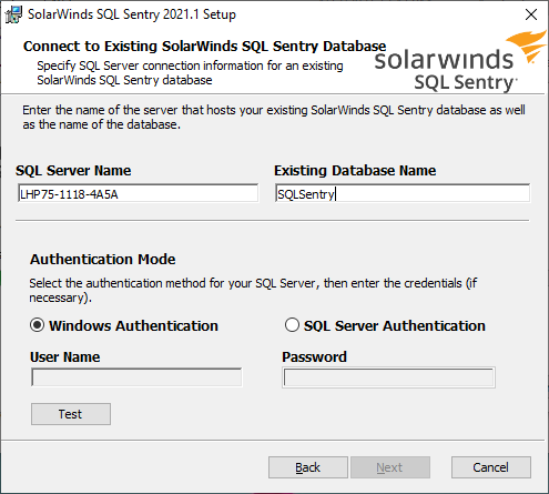

  2. On the Connect to Existing SQL Sentry Database screen enter the information needed to connect to your existing SQL Sentry database installation.
    SentryOne Setup Wizard Connect to Existing SentryOne Database
  3. Select Test to validate your connection details, then Next to continue installing the Software Client.
