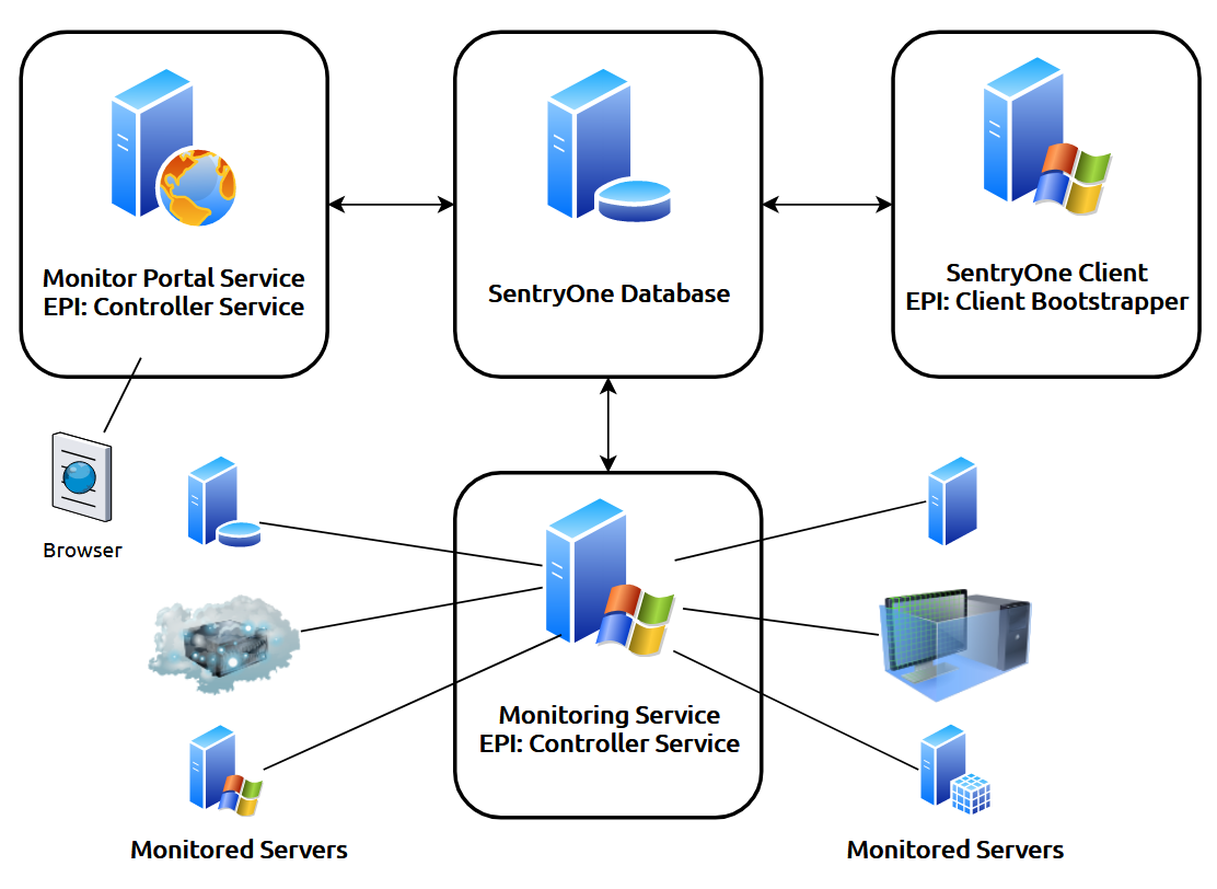

Installation Example
SQL Sentry Installed Software Components and Architecture
Example of SQL Sentry (SentryOne) components installed across multiple machines (with EPI components when applicable)

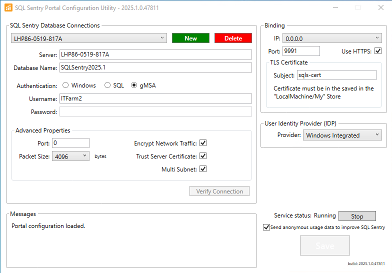

SQL Sentry Portal Configuration Utility
Changes to your SQL Sentry Portal configuration must be made through the Portal Configuration Utility (PCU).
Note:  For the EPI version of SQL Sentry, the Portal Configuration Utility is only available in versions 2020.8.31 or later. Earlier EPI releases must uninstall/reinstall via command line to make changes.

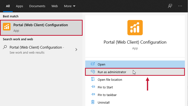

Access the PCU
SQL Sentry
Locate the PCU through the file directory or use the Windows Start menu as Portal (Web Client) Configuration. Use the Run as administrator option to open it.
SQL Sentry Portal Configuration Utility Run as administrator
File path:
  1. Navigate to the MonitorPortal directory in your SQL Sentry installation. The default path is C:\Program Files\SolarWinds SQL Sentry\<Version>\MonitorPortal\PCU. In this example, it is C:\Program Files\SentryOne\2020.0\MonitorPortal.
SQL Sentry EPI Version
  1. Use the so configmp command to launch the Portal Configuration Utility from Command Prompt.
    Note:  You must run this command on the machine where SQL Sentry Portal is installed.
  2. You must use the EPI commands so stopmp and so startmp after making changes to the configuration. The PCU does not restart the portal service in an EPI environment.
Use the PCU
The PCU allows you to change database, network, security, and web server binding-related properties for SQL Sentry Portal. Select the Verify Connection button to verify your connection settings and then select Save to apply any changes.
The PCU also provides an option to stop/start the SQL Sentry Portal service (SentryOne Monitor Portal in Windows Services).
Note:  SQL Sentry Portal supports distributed SQL Sentry databases. The drop-down menu at the top allows you to switch between the settings for each SQL Sentry database.
Additional Information: If you have multiple SQL Sentry databases and would like to view all of them in the same SQL Sentry Portal, see the distributed databases article for setup and security details.
Important:  The default URL to access the SQL Sentry Portal is http://localhost:9991.
Additional Information: For more information about the settings in the Advanced Properties:

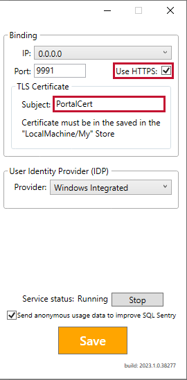

Use TLS
To use TLS for SQL Sentry Portal:
  1. Select the box next to Use HTTPS. Once selected, you'll see the TLS Certificate section.
  2. Enter the name of the certificate in Subject.
  3. Select Save.
  4. The Messages section displays the progress. Note that the SQL Sentry Portal service will be restarted during this process.
    SQL Sentry Portal SSL Certificate
Success: You have enabled TLS for SQL Sentry Portal. Use HTTPS:// at the beginning of the URL to open it in your browser.

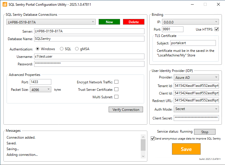

Add New SQL Sentry Portal Connections
  1. Select New to open the Add New Connection window.
  2. Enter a name for the new portal connection, and then click Confirm.
  3. Enter the Server and Database Name for your connection.
  4. Select your authentication method Windows, SQL, or gMSA and enter your connection credentials.
    • Windows: Enter the Windows username and password for your database connection.
    • SQL: Enter the SQL Server username and password for your database connection.
    • gMSA: Enter the account name for your Group Managed Service Account (gMSA).
    For Unified Installations, you must update your SentryOne Monitor Portal Service account in Windows Services to the gMSA account you configured in SQL Sentry Portal to authenticate with the SQL Sentry database.
    For EPI installations, you must update the SentryOne Monitor Portal Service account to the configured gMSA account with the installmp command.
  5. Select Verify Connection to test your connection.
  6. Configure any applicable Advanced Properties, Bindings, and the User Identity Provider.
  7. Select Save to save your Portal Connection.

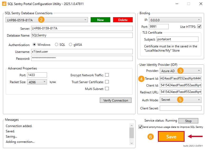

Create a New or configure an existing SQL Sentry Portal Connection to use your Azure AD IDP credentials:
  1. Open the SQL Sentry Portal Configuration Utility.
  2. Click New to create a new repository connection or select the desired connection from the drop-down menu.
  3. Select Azure AD from the Provider drop-down menu.
  4. Enter the Tenant id, Client id, and Redirect URL associated with you Azure AD application.
  5. Select your Auth Mode (Secret or Certificate) and enter your Client Secret or Certificate credentials.
    1. Select Secret to use the Azure AD Secret associated with your credentials. Enter your Client Secret.
    2. Select Certificate to use the Certificate associated with your Azure credentials. Select Browse to open the file explorer and select your certificate. Enter the password for the certificate.
  6. Click Save to save your credentials.
