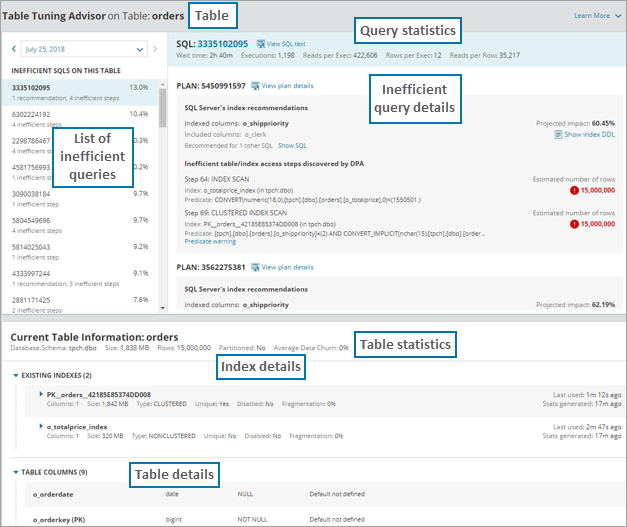

What are table tuning advisors?
At the end of each day, DPA runs an analysis to identify tables that had inefficient queries run against them during that day. For each of these tables, the Table Tuning Advisor page displays aggregated information about the table, the inefficient queries that ran against it, and any existing indexes. This information helps you optimize query performance while taking indexing trade-offs into account.

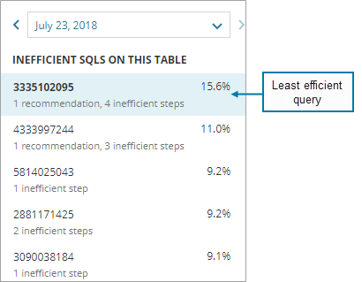

Examine the list of inefficient queries
The top-left pane lists the inefficient queries that ran against the table on the selected day. DPA assigns a relative efficiency score to each query and uses this score sort the list.
Select a query from this list to display detailed information about it.
Tips for using this information
Focus your tuning efforts on the queries at the top of the list, which are driving the most inefficient workload against this table.
- A large number of queries in the list could indicate a more widespread performance issue. Perhaps one good index could improve the performance of several similar queries.

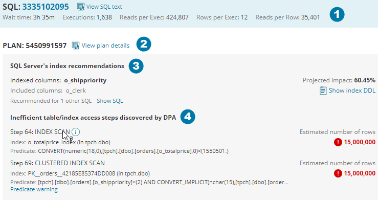

Examine query details
The upper-right pane displays information about the selected query that can help you determine the source of read inefficiencies against this table.
The performance statistics at the top of the pane show the extent of the query's inefficiency:
For more information about the query, click the SQL name or hash value to view DPA's query performance analysis, which shows when the query ran, the execution statistics, and the most relevant metrics charts. |
DPA lists each execution plan that it finds. You can click the link to examine the full plan, but DPA lists the steps most likely to need attention below. |
(SQL Server and Azure only) Index recommendations made by the SQL Server optimizer, if any, are listed. The Projected Impact is the cost reduction that the optimizer estimates the recommended index will have. Click Show index DDL to see the CREATE INDEX statement for the recommendation. |
DPA analyzes the plan and lists steps with the most inefficient access paths. These steps read data to be processed by subsequent "consumer" plan steps. While consumer steps (for example, sorts) can have a high plan cost, they are usually affected by a preceding step that read too much data. Information about each step includes:
Before you add an index, weigh the projected impact or potential performance improvement against indexing trade-offs. Also consider the indexing needs of other queries.
Click any step to get detailed information about the operation and recommendations for potentially reducing the amount of I/O.
If predicates are listed, they often indicate which columns need to be indexed, or where the optimizer is not using an existing index. For example, if the query calls a function on the column, the plan will not use an index.
If warnings are listed, click the warning for a detailed description of the condition that DPA has identified as a potential reason for concern.
Warnings
DPA provides the following warnings:
A predicate warning occurs when a column needs to be converted to a different data type before it can be used. For example, if a query has a JOIN clause that equates a numeric column to a varchar column, one of the columns will be implicitly converted to the other's type. The optimizer typically does not use an index on an implicitly converted column. This is often why the optimizer doesn't use an existing index that the query's author expected it to use.
A lookup warning typically indicates that the database is doing an index lookup to identify the target rows, then doing an extra table access to get data not found in the indexed columns. To get better performance, consider adding a covering index, or extending an existing index to include columns needed to avoid the table lookup. However, remember that adding a large number of columns can increase the index size and maintenance overhead.
A spool warning indicates that the step's result set is being stored for reuse later in the query's execution. While spool operations are often beneficial, the intermediate data storage can cause disk overhead and contention.
A parallel warning indicates that DPA has detected a parallelism step later in this query's execution, implying that this step's intermediate result set is likely large enough to exceed parallel processing cost thresholds. Look for ways to rewrite the query to reduce the size of intermediate result sets earlier in the query. For example, look for a sub-select that could produce fewer rows or the nested loop join order if more than two tables are involved.
Examine table statistics
At the top of the Current table information section, DPA provides table statistics, such as the size of the table and the amount of churn. A table's churn is the daily number of insert and delete operation expressed as a percentage of the total number of table rows.

Examine index details
DPA displays information about all existing indexes on the table, including the structure, the amount of fragmentation, how long ago the statistics were generated, and when the index was last used.
