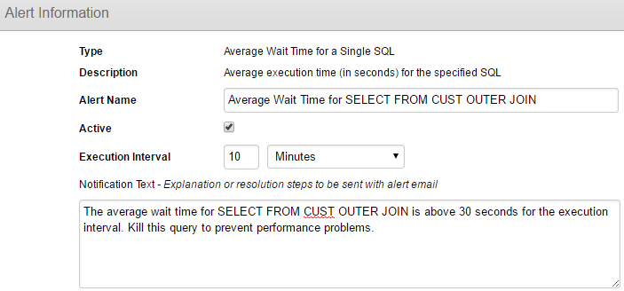

  5. In the Alert Information section, enter a unique name and select the execution interval.
    The execution interval specifies how often the alert runs and also the amount of data that DPA examines. For example, if the execution interval is 10 minutes, DPA executes the alert every 10 minutes and queries the last 10 minutes of data to determine whether to trigger the alert.
    SolarWinds recommends an execution interval of at least 10 minutes. This allows time for valid samples and prevents unnecessary alerts from a single slow execution.
    Alerts are active by default. Clear the Active check box to disable an alert but not delete it.
  6. Enter the text to be sent with the email or page notification. You can include an explanation of the alert and the suggested resolution.

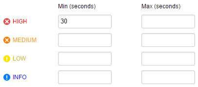

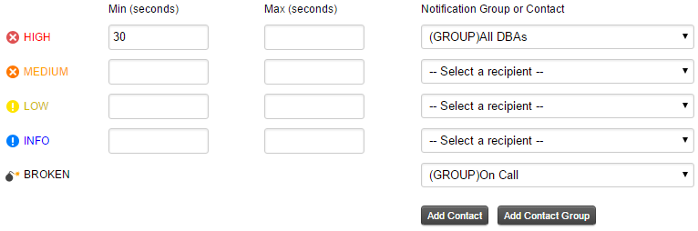

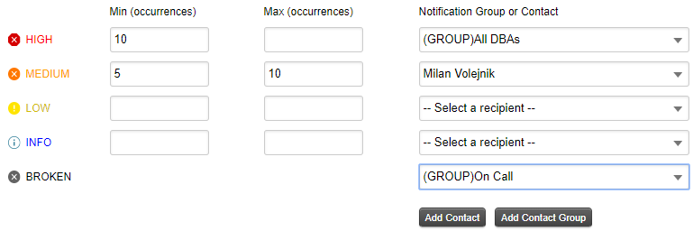

  9. For all Wait Time alerts except Database Instance Wait Time Anomaly, specify the thresholds for each alert level you want to enable.
    Leave the max value for the highest level blank to alert on anything above the minimum value for that level. If you configure multiple levels, the Max value for lower levels must equal the Min value for the next higher level.

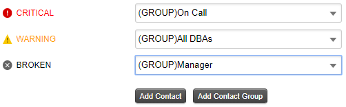

  10. Select the person or group who gets notified when an alert level is triggered or when the alert is broken. (The alert status is set to Broken if an error occurs during execution.)
    • If you have not added the person or group as a contact in DPA, click Add Contact or Add Contact Group and create the contact or group.
    • Select an SNMP contact to send SNMP traps when this alert is triggered.
  11. Verify or change the notification policy.

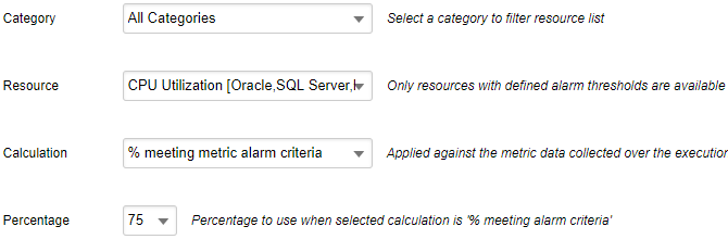

  9. Specify the following Alert Parameters:
    1. For alerts against all metrics in a category, select the category.
      For alerts against a single resource metric, you can select a category to filter the Resource list.
    2. For alerts against a single resource metric, select the resource.
    3. Specify the calculation that is used to determine the alert level for an execution interval.
      To determine the alert level, DPA looks at the values collected during an execution interval and applies the specified calculation. For example for a single resource alert, if the metric value is collected once each minute and the execution interval is 10 minutes, DPA looks at the 10 values collected for an interval and applies one of the following calculations.

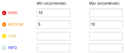

  8. Specify the thresholds for each alert level you want to enable. (Some Administrative alerts have only one level.)
