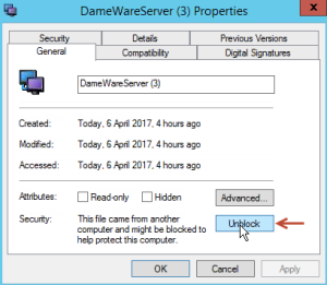

  2. Right-click the Dameware Server executable, and select Properties.
  3. If you see an Unblock button, click it, and then click OK.
    If the executable is blocked, Dameware does not install correctly.

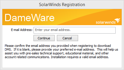

    As the installation progresses, a dialog box opens, prompting you to enter an email address. If you do not enter an email address, the installation does not complete.

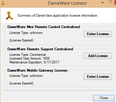

Task 4: Enter your Dameware license keys
You can enter your Dameware license keys during the installation process, or after the installation completes. The steps below show you how to activate your license during the installation process. If you want to activate your license after the installation completes, see Activate a Dameware license.
  1. On the Dameware Licensor dialog box, enter the Dameware Remote Support centralized license key.
    The Dameware Licensor dialog box opens at the end of the installation.
    For detailed instructions on using the Licensor to activate your product, see Activate a Dameware license.
  2. If you are using the Dameware Mobile Gateway, enter that license key.
    You are issued a separate license key for the Dameware Mobile Gateway.
    To locate your Dameware license key is, log in to the SolarWinds Customer Portal, and click Licenses > Manage License.

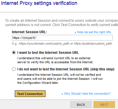

  3. Enter the Internet Session URL, and click Test Connection.
    If you are using port 443, you do not need to specify that in the URL. Dameware assumes that you are using port 443. If you are using a different port number, you must add that port number to the URL.
    The Internet Session URL is the URL that you send out to your remote end users. This field defines the DNS, which can be a fully qualified name or IP address. The Internet Session URL must be NAT'd to a public IP address.
    The Test Connection button is hard-coded to test against port 443. If you have changed the port, the test fails, but the Internet Session URL can be valid. If the test fails and you are using port 443, then troubleshoot the Internet Session URL.
