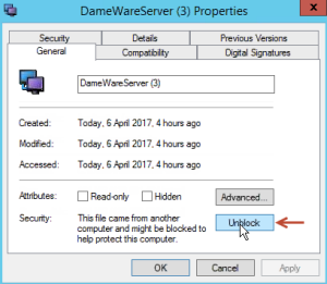

  2. Right-click the Dameware Server executable, and select Properties.
  3. If you see an Unblock button, click it, and then click OK.
    If the executable is blocked, Dameware does not install correctly.

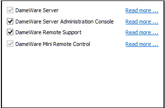

  5. On the Advanced Install Options dialog box, select the components that you want to install on the Central Server, and click Next.
    The first server on which you install Dameware is considered the Central Server.
    SolarWinds recommends that you accept the default setting, and install all components on the Central Server.
    At a minimum, you must install Dameware Server on the Central Server.

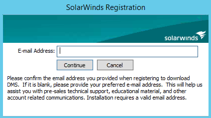

    As the installation progresses, a dialog box displays, prompting you to enter an email address. If you do not enter an email address, the installation does not complete.

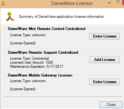

  1. On the Dameware Licensor dialog box, enter the Dameware Remote Support centralized license key.
    The Dameware Licensor dialog box opens at the end of the installation.
    For detailed instructions on using the Licensor to activate your product, see Activate a Dameware license.
  2. If you are using the Dameware Mobile Gateway, enter that license key.
    You are issued a separate license key for the Dameware Mobile Gateway.
    To locate your Dameware license keys, log in to the SolarWinds Customer Portal, and click Licenses > Manage License.

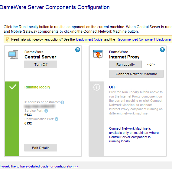

  2. On the Select configuration options panel, click Advanced Configuration, and click Next.
  3. On the Dameware Server Components Configuration panel, for the Central Server, click Run Locally, and click Next.
  4. On the Configuration completed panel, click Finish.

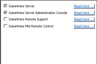

  6. On the Advanced Install Options dialog box, select the components that you want to install on the Central Server, and click Next.
    SolarWinds recommends that you install the Dameware Server and the Dameware Server Administration Console.
    At a minimum, you must install Dameware Server on the second server.

    As the installation progresses, a dialog box opens, prompting you to enter an email address. If you do not enter an email address, the installation does not complete.

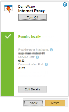

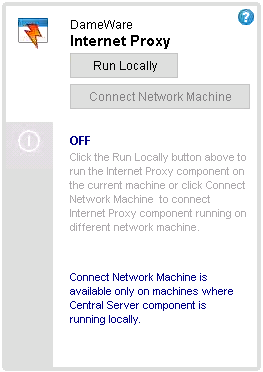

  3. On the Dameware Server Components Configuration panel, select the components you want to run on the local machine, and click Next.
    In this three-server scenario, click Run Locally for the Internet Proxy.

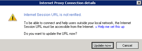

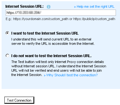

  4. At the end of the configuration, the Configuration Wizards prompts you to enter the Internet Session URL. Click Update Now.
    The Internet Session URL is the URL that you send out to your customers. This field defines the DNS, which can be a fully qualified name or IP address. The Internet Session URL must be NAT'd to a public IP address.
  5. Enter the Internet Session URL, and click Test Connection.
    If you are using port 443, you do not need to specify that in the URL. Dameware assumes that you are using port 443. If you are using a different port number, you must add that port number to the URL.
    The Test Connection button is hard-coded to test against port 443. If you have changed the port, the test fails, but the Internet Session URL can be valid. If the test fails and you are using port 443, then troubleshoot the Internet Session URL.
    For more information on configuring the Internet Session URL, see Install the Dameware Internet Proxy with another web server, Specify the Internet Session URL in Dameware, and Modify your firewall or router to support Internet Sessions in Dameware Mini Remote Control.
  6. After you have tested the connection, on the Edit Internet Proxy Connection Details page, click Save.
    On the Dameware Components Configuration panel, the Internet Proxy status turns green when the URL test passes.

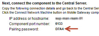

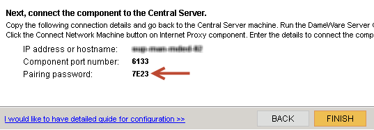

  8. On the Configuration completed panel, make note of the pairing password, and click Finish.
    In the next task, you go back to the first server and use the pairing password to authenticate the connection between the Dameware Central Server and the Internet Proxy.

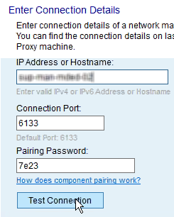

Task 8: Enter the Internet Proxy pairing password on Server 1
  1. Log in to Server 1.
  2. Search for and open the Dameware Configuration Wizard.
  3. In the Internet Proxy area, click Connect Network Machine.
  4. Enter the IP Address or hostname, and pairing password of the Internet Proxy server.
  5. Click Test Connection, and click Save.
    A successful test means that the Central Server can communicate with the Internet Proxy.

    Remember to enter an email address. If you do not enter an email address, the installation does not complete.

  4. On the Configuration completed panel, make note of the pairing password, and click Finish.
    You will configure the first server to use the pairing password to authenticate the connection between the Central Server and the Mobile Gateway.
Task 11: Enter the Mobile Gateway pairing password on Server 1
  2. Open the Dameware Configuration Wizard.
  3. In the Mobile Gateway area, click Connect Network Machine.
  4. Enter the IP Address or hostname of the Mobile Gateway server, and the pairing password.
    A successful test means that the Dameware Central Server can communicate with the Mobile Gateway.
