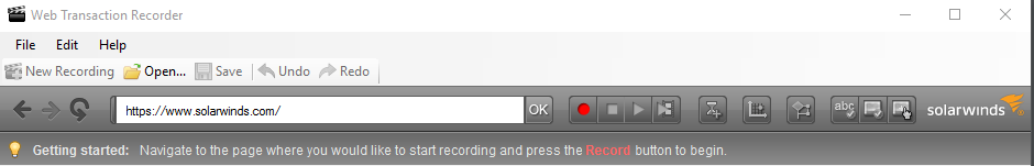

  1. From the Windows Start menu, click Start, type WPM, and click WPM Recorder (deprecated).
  2. In the Web Transaction Recorder window, enter the URL of the web page you are recording.

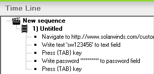

  3. Click Record and begin the sequence. All browser actions are recorded, as displayed in the Time Line pane on the right side of the recorder, as shown below:
  4. When finished, click Stop . .

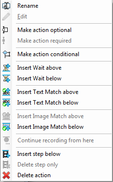

  • Click Undo to step back through any incorrect actions in the Time Line.
  • To edit a step, right-click the step in the Time Line and select a menu option.
New steps can be added between two existing actions or at the end of the last step in the recording.
The default timeout threshold for pages is 30 seconds. To specify a longer period, insert a Wait time before or after a step.
Wait times are not included in the recorded time for the transactions.
To add Wait times:
  1. Right-click on the step before or after which you want to insert a pause.
  2. Select Insert Wait above or Insert Wait below.
  3. Select the time to wait, and click OK.
To remove an action:
  1. Select the unnecessary action, and press the Delete key.
  2. Click Yes to confirm the deletion when prompted.

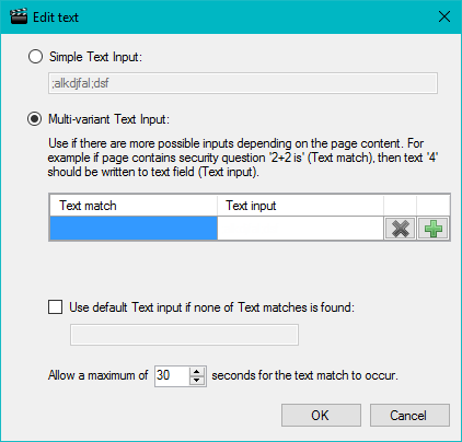

To correct errors in text field actions:
  1. Double-click the text field action in the Time Line pane.
  2. Enter the corrected text in the Simple Text Input box, or enter the multi-variant text in the Multi-Variant Text Input box, and then click OK.
  3. When finished, click Stop and the WPM Recorder plays back the recording.
