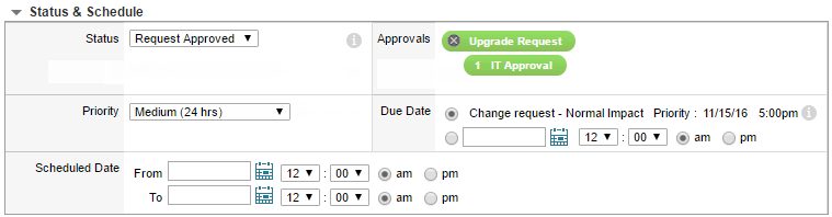

  7. Open the ticket and review the status.
    If you approve the ticket, the status changes to Request Approved. If you reject the ticket, the status changes to Request Denied.
    You can also use the Approvals field to track where tickets are in the approval process, and if necessary, you can override an approval step.

  13. Scroll up to the Status & Schedule tab and review the status.
