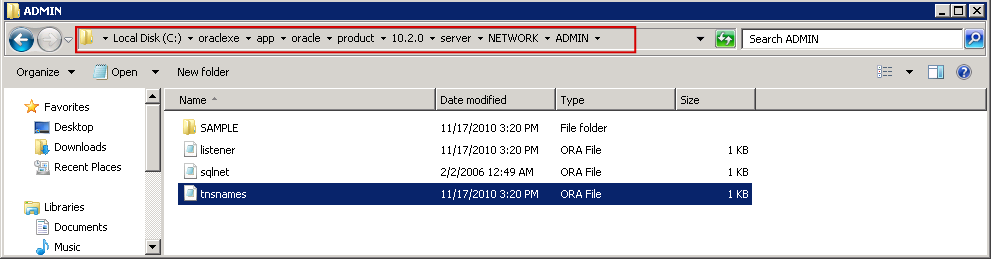

  1. Log in to the Oracle server as an administrator.
  2. Navigate to the tnsnames.ora file. The default location is $ORACLE_HOME/network/admin/tnsnames.ora, where $ORACLE_HOME is the directory where the Oracle Server is installed.
  3. Open the tnsnames.ora file and follow these steps to extract the required information.

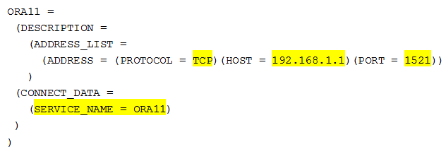

    1. Locate the section that describes options for the database instance you want to monitor, such as Protocol, Host, and Port, as shown in the examples below.
    2. Extract the following settings for use in the Oracle User Experience Monitor:
      • Protocol: Must be TCP so SAM can connect to the target Oracle server.
      • Host: Must match the IP address (or hostname that resolves to that IP) of the target node in SAM.
      • Port: Use this setting for the Port Number field of Oracle User Experience Monitor.
      • Service_Name: If this value exists, use it as the Service_Name for the Destination Point Type field of the Oracle User Experience Monitor.
      • SID: If this value exists, use it as the SID value for the Destination Point Type field of the Oracle User Experience Monitor.
      • Service_Name or SID settings in tnsnames.ora also defines a connection point name (after the "=" character), which needs to be used for the Destination Point Name field of the Oracle User Experience Monitor.
Example 1: Following is a sample tnsnames.ora file where key settings are highlighted:

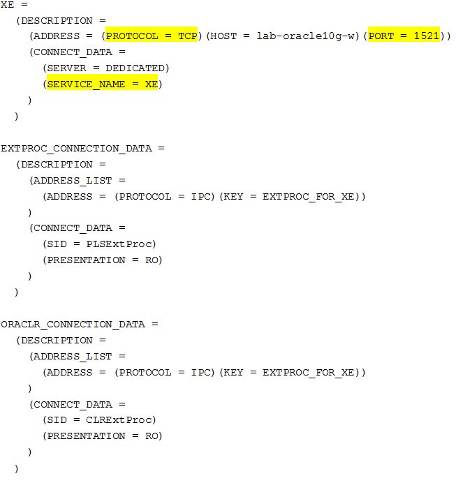

Example 2:

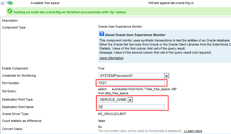

Here is a sample configuration of the Oracle User Experience Monitor for Example 1:
