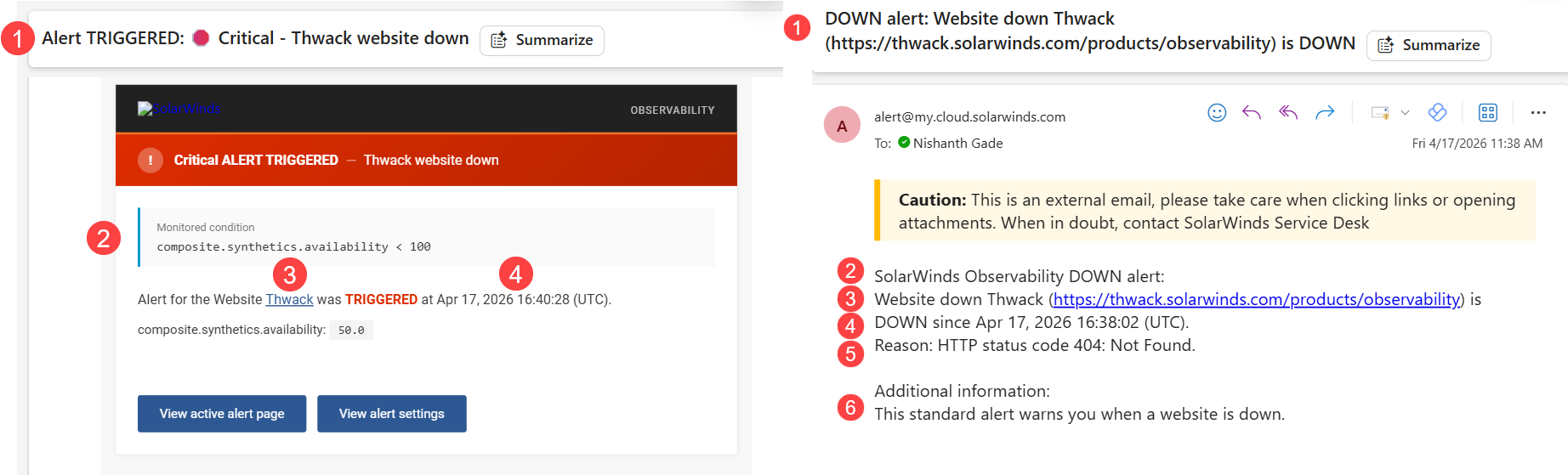

Pingdom-style alerts in SolarWinds Observability resemble the alerts you may have been familiar with in Pingdom, as the name suggests. The image below displays a standard SolarWinds Observability alert (left) and a Pingdom-style alert (right).
See the table below for some key differences.
SolarWinds Observability standard alert SolarWinds Observability Pingdom-style alert
1. Uses a general subject line describing alert such as Critical ALERT Triggered - Website down. 1. Uses a clearly defined subject lines such as DOWN alert: Website down
2. Uses the Monitored condition such as composite.synthetics.availability. 2. Uses the state.nativeState == down attribute.
3. Links to the related entity.
3. Links to the affected website, URI, or Synthethic transaction entity.
4. Notifies you when the alert was triggered in UTC. 4. Lists the entity's current status
5. Lists the reason for the entity's status
  6. Adds additional information relating to the alert

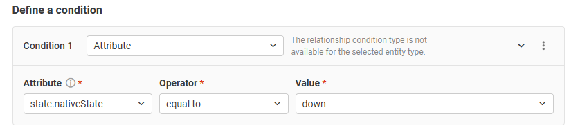

  6. Review the settings on the Conditions page. The templates are configured to alert you when the state.nativeState of any monitored website, URI, or Synthetic transaction entity is down. You can keep this configuration, or refine the scope to trigger only for selected websites.
  7. Configure the alert scope and condition:
    The Digital Experience alerting templates have the state.nativeState == down attribute configured by default as shown in the image.
    1. Entity type: The Website, URI, or Synthetic transaction entity type is selected by default (based on the selected template).
    2. Scope by: All is selected by default.
    3. Alert Condition: state.nativeState == down is selected by default.
    4. Click Next.
