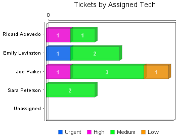

This example shows how many open tickets are assigned to each tech. The information is displayed in a bar chart, which you can use to quickly identify techs with the highest number of open tickets. Each bar is subgrouped by ticket priority.

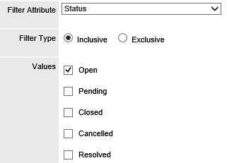

  13. Click the Report Filters tab, and then click New.
  14. Create a filter to include only tickets with a Status of Open.
  15. Click Save, and then click Run Report.
    The bar chart shows the number of open tickets for each tech. This information is also shown in a table below the chart.

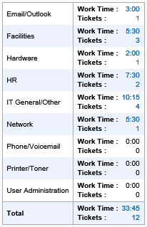

This example shows how many tickets of each request type were closed during the previous week. It also shows the total amount of work time for each group of tickets. The information is displayed in a table because tables can include multiple data points for each ticket.

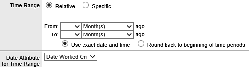

  8. Select the time range that the report will include. Select the Round back option to include the previous week from Sunday through Sunday (rather than today and the previous seven days).
  9. To include only tickets closed during the specified time range, select Date Closed as the Date Attribute.

    The report shows the total number of tickets and total work time for each request type.

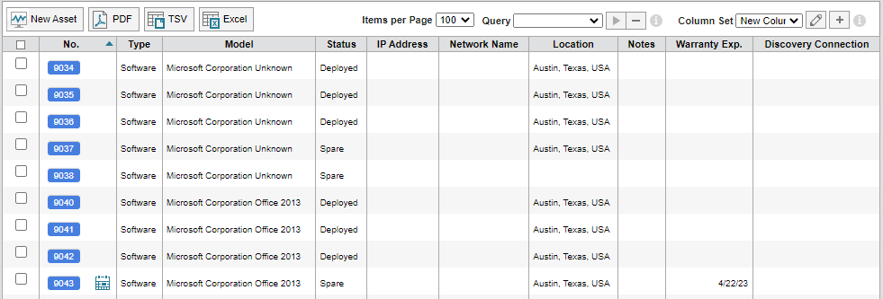

This example displays Microsoft software products installed on computer systems configured as assets in Web Help Desk. The report lists the product and the deployment status.
  1. Click Assets > Search Assets.
  2. Click the Advanced Search tab.
  3. Select the following options for your search.
  4. Click Search.
    The results are displayed in the table, as shown below. Some results may be displayed as unknown. This occurs when a software product is new and Web Help Desk does not recognize the product.

    8. In the Time Range row, select the amount of time to include in the report. . The time range applies to the Date Attribute for Time Range selection. Click tooltip for configuration details.
    9. Click the Date Attribute for Time Range drop-down menu and select Date Closed.
