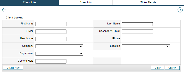

  3. If the ticket is to report a client issue, complete the Client Lookup fields in the Client Info tab to locate and select the client.
    1. Enter and select the client details in the tab window.
    2. Click Search.
    3. In the Client Name column, locate and click the client name.

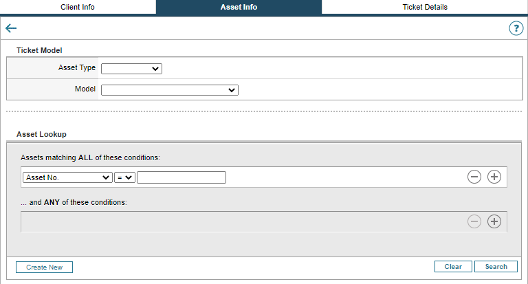

  4. If the ticket requires an asset, locate the asset.
    1. Click the Asset Info tab.
    2. Select the asset type and model. You can also locate the asset using a Boolean search in Asset Lookup.
    3. Click Search.
    4. Locate the asset in the search results.

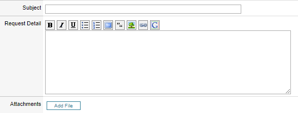

  8. Enter a subject and the request details that describe the issue. If you need to add an attachment, click Add File.

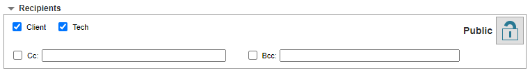

  10. Under Recipients, select the Client or Tech checkbox to indicate who receives details about this ticket. If the recipient is not a client or tech, enter their email address in the Cc or Bcc fields and then select the corresponding checkbox. See Enable ticket updates from unauthorized users for guidance.
  11. (Optional) Click the lock to toggle the ticket privacy setting.
    If you select Private, users without permission cannot see the tickets.
