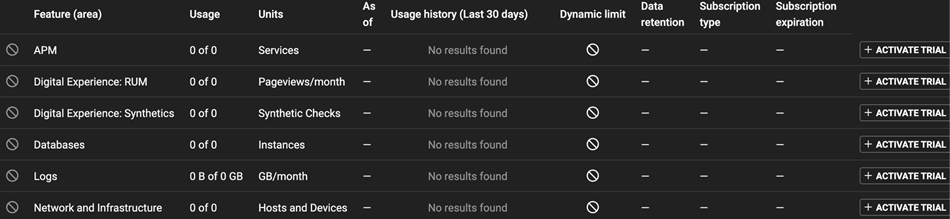

A SolarWinds Observability SaaS account is required to use Platform Connect functionality. If you do not have a SolarWinds Observability SaaS account, you can create an account when you connect to SolarWinds Observability SaaS (as described in the instructions below). Your DPA license type determines what type of SolarWinds Observability SaaS account is created:
  • If you have one or more subscription or temporary DPA licenses for your monitored instances:
    • The SolarWinds Observability SaaS account that is created when you establish the connection has a term limit of one year.
    • That account cannot be used to activate a trial of any SolarWinds Observability SaaS features.
    • Before the end of the one-year term, call Support to extend the term for the SolarWinds Observability SaaS account based on the term of your DPA licenses.
  • If you have an evaluation license for DPA, a SolarWinds Observability SaaS trial account is created for you when you connect to SolarWinds Observability SaaS. You can use this trial account for 30 days. If you change your DPA license from an evaluation license to a temporary or subscription license, you must contact Sales or Support to extend the SolarWinds Observability SaaS trial account.
  • If you install DPA with Platform Connect on a DPA AWS AMI server, a SolarWinds Observability SaaS trial account is created that you can use for 30 days. If you want to extend the SolarWinds Observability SaaS trial account, contact Sales or Support.

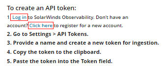

  6. If you have a SolarWinds Observability SaaS account, click the Log in link on the Create Account/Configure Token page to open SolarWinds Observability SaaS. Then continue with the next step.
    If you do not have a SolarWinds Observability SaaS account, complete the following steps to create an account.
    1. Click the Click here link on the Create Account/Configure Token page.

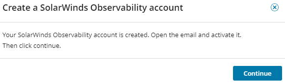

    2. Enter your information and select a Cloud Provider. Then click Create.
      A message tells you that your account has been created.
    3. Check your email. When you receive an email from solarwinds.com, open it.

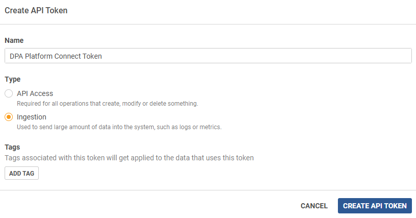

  8. In the My Settings menu, click API Tokens.
  9. Click Create API Token.
  10. Enter a name, verify that Ingestion is selected, and click Create API Token.
    A dialog displays the API token.
  11. Click the clipboard icon to copy the token to the clipboard. Then click Close.
  12. Return to the browser tab in which DPA is running. On the Create a SolarWinds Observability account dialog, click Continue to close the dialog.

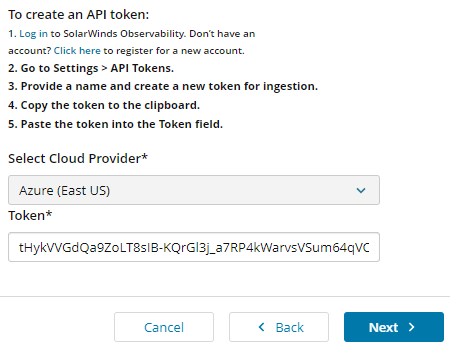

  13. Select a cloud provider, and paste the copied token into the Token field. Then click Next.
    The Install Agent page opens.
