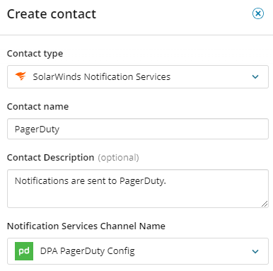

Create a contact to send notifications to a notification service
When you create an alert definition and select this contact to receive notifications, the notifications are sent to the associated notification service.
  1. Log in to DPA using an account with administrator privileges.
  2. From the DPA menu in the upper-right corner, click Options.
  3. Under Administration > Users & Contacts, click Contact Management.
  4. On the Contact management page, click Create contact.
    If any contacts are selected, the Create contact button is not displayed.
  5. Under Contact type, select SolarWinds Notification Services.
  6. Enter a name and, optionally, a description.
  7. Under Notification Services Channel Name, select the name associated with the notification service you want to send notifications to.
  8. To test the configuration, click Send Test Notification and verify that the test was sent to the notification service.
  9. (Optional) Add the contact to one or more groups.
    1. Click the down-arrow under Assign contact to groups.
    2. Click a group name to select the group.
      The group is shown in the Assign contacts to groups box.
    3. Repeat these steps to add the contact to more groups.
  10. Click Create.
    The contact is added to the list of contacts.

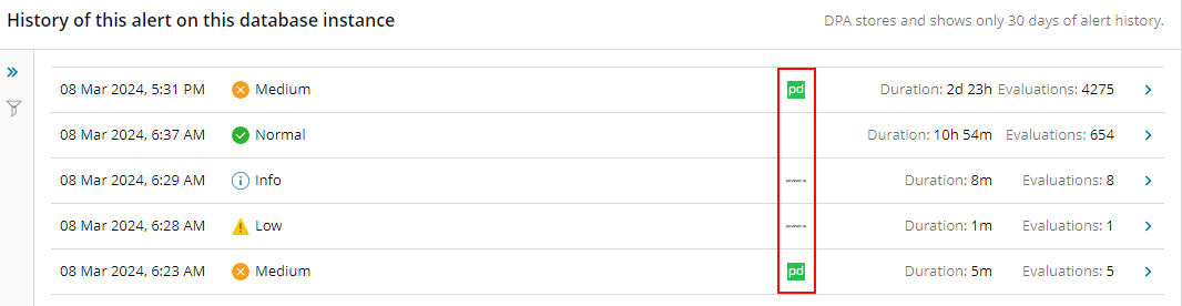

Indication that the notification was forwarded
To confirm that an alert notification was forwarded to ServiceNow or PagerDuty, view the alert history.
  1. From the DPA menu in the upper-right corner, click Alerts.
    The Current alert status page shows information about DPA alerts that are currently active.
  2. Click the name of the alert. The Alert details page opens.
  3. Scroll down to the History of this alert on this database instance page.
    A PagerDuty or ServiceNow icon is displayed for notifications that were forwarded to a notification service.
