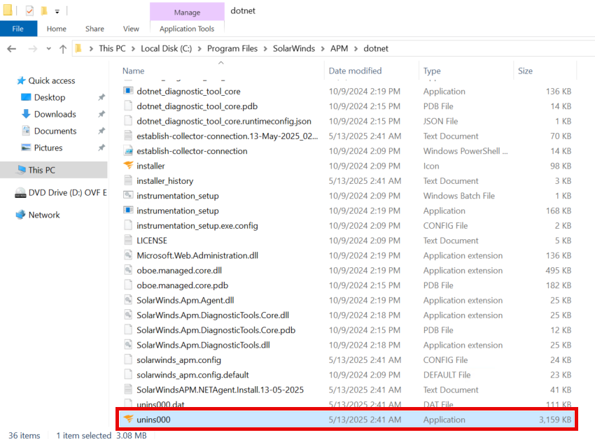

    2. Navigate to the C:\Program Files\SolarWinds\APM\dotnet directory, locate and run the unins000.exe file.

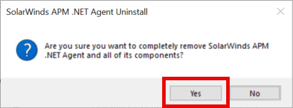

    3. In the modal window that opens, click Yes to confirm uninstalling of the AppOptics agent and all its components.

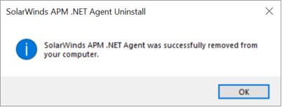

    4. Once the uninstall process is complete, a message will confirm successful removal of the agent. Click OK to close the modal.

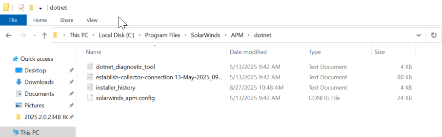

      Some log files may remain in the installation directory, which are no longer needed. The entire \APM\dotnet can be safely deleted.

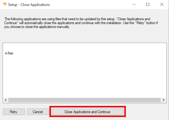

If the agent is installed on the node where SolarWinds Observability Self-Hosted is also installed, you may encounter a prompt during the uninstall process indicating that the application, w3wp must be stopped.
In this case, you can proceed in one of two ways:
  • Open the SolarWinds Platform Service Manager, and stop the SolarWinds NetPerfMon service before continuing with the uninstall process, or
  • Click Close Applications and Continue in the Setup - Close Applications window, which will automatically perform the necessary actions and continue with the uninstall process.
