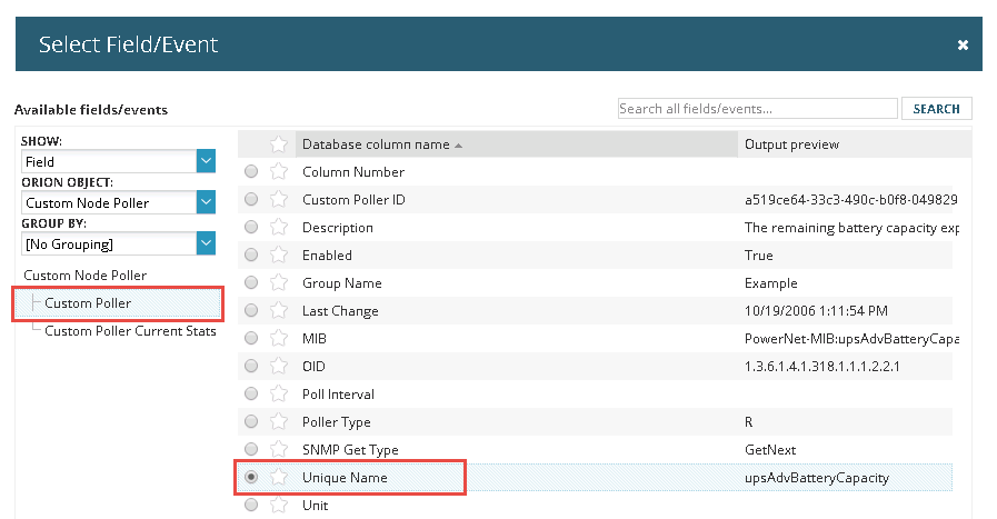

  3. Define the UnDP:
    1. Click Select Field in the drop-down list next to Custom Node Poller and then select Browse all Fields.
    2. Select Custom Poller in the Custom Node Poller tree, and then select Unique Name.
    3. Click Select to confirm your selection.
    4. Select the Is equal to condition in the third drop-down list.
    5. Enter BlackTonnerLevel into the fourth field in the row.
      Press the down arrow on your keyboard to display all available values.
