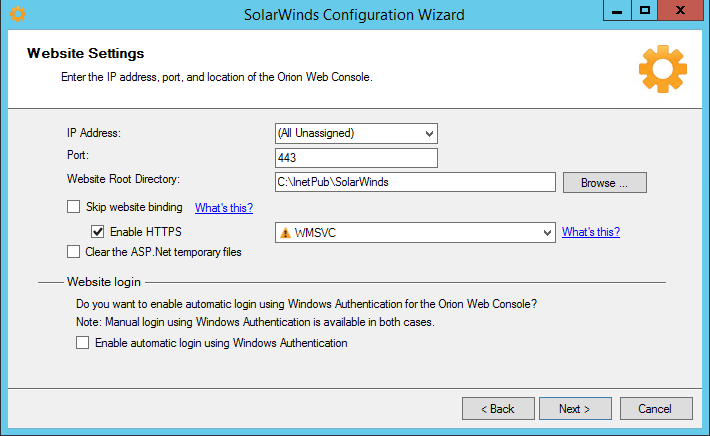

Use a previously installed SSL certificate
  1. Select Enable HTTPS.
  2. Choose the certificate you want to use. Certificates with a green check mark are least likely to generate browser warnings.
  3. Complete the Configuration Wizard.
The Configuration Wizard enables the SolarWinds Platform Web Console to use SSL for the specified port, adds the website binding to the SolarWinds Platform Web Console, and forces the website to use HTTPS by default.
After the Configuration Wizard is finished, the SolarWinds Platform Web Console opens using HTTPS. If you used a certificate with a green check mark next to it, there should be no browser warnings. If you used a certificate with a yellow warning sign next to it, you may have a browser warning.

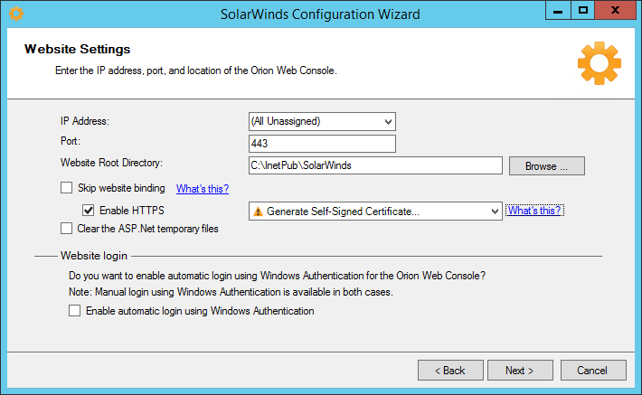

Generate a self-signed certificate
You can generate a self-signed certificate directly in the Configuration Wizard.
  2. Scroll to the bottom of the list and select Generate Self-Signed Certificate.
A self-signed certificate is issued to the machine host name or fully qualified domain name (FQDN) when the computer is part of a domain, and the certificate is added to the trusted certificate store. After the Configuration Wizard is finished, the SolarWinds Platform Web Console opens using HTTPS.
The certificate authority for self-signed certificates is the computer hosting your SolarWinds Platform server. Depending on your security and group policy settings, the SolarWinds Platform Web Console may generate browser errors because the certificate was not issued by a known certificate authority.
Use SSL after you install an Orion product
You can still use the Configuration Wizard to add the binding to your SolarWinds Platform Web Console after you have installed a SolarWinds Platform product.
You must install an SSL certificate on the SolarWinds Platform server before performing the following steps.
  1. Log in to your SolarWinds Platform server as an administrator.
  2. Run the Configuration Wizard from the Start menu.
  3. Select Configure the website, and click Next.
  4. Clear the Skip website binding option.
  5. Select Enable HTTPS.
  6. Choose the installed certificate. If the certificate does not show in the list, review how certificates are categorized.
