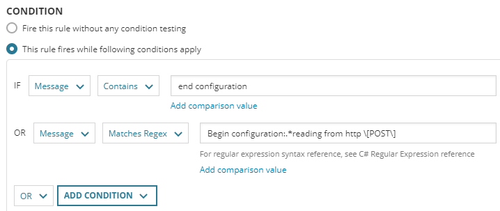

If you have devices other than Cisco ASA and IOS devices, complete these steps to configure a custom rule.
  1. In the SolarWinds Platform Web Console, click My Dashboards > Logs > Log Viewer.
  2. In the upper-right corner, click Settings.
  3. In the left pane, expand either Syslog or Traps, and click My Custom Rules.
  4. Click Create, enter a descriptive name, and click Next.
  5. Specify the condition:
    1. Under Condition, select This rule files while following conditions apply.
    2. Next to If, select Message.
    3. Select either Contains or Matches Regex, depending on whether you are entering a simple string or a regular expression.
    4. Enter a string or regular expression to identify the syslog message that the device sends when a config has been changed.
      The message varies by device type. For example, when a change is made to a Cisco router config, the device sends a syslog message containing Configured from console. Message text is case-sensitive.
      For more information about what messages a device sends, see the device documentation.
      The message text used to trigger the rule should be from a message received after all the changes made in the session have been completed (for example, when exiting configuration mode).
    5. If the rule applies to multiple device types, select Or, click Add Condition > Field condition, and specify another string or regular expression.
    6. Click Next.

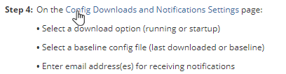

Step 4: Specify config comparison and email notification options
When a config change is detected, NCM accesses the device, downloads the modified config file, and compares it to an existing config file to determine what changed. NCM then emails the specified recipients to notify them of the changes. Complete the following steps to specify config comparison and email notification options.
  1. Open the Real-Time Change Detection page.
  2. Click the Config Downloads and Notification Settings link in Step 4.
  3. Under Previously Downloaded Config File, select the type of config file that NCM should download for comparison when a config change is detected.
  4. Under Baseline Config File, select the config file you want NCM to use for comparison when it determines what changed.
  5. Select the desired Email Notification Options.
  6. Enter the Sender Name and Subject for NCM to use in RTCD email notifications, and specify at least one recipient. The Reply Address is optional.
    Email notification fields can include the following types of variables (also called macros). For example, use ${DateTime} to include the date and time in the Subject.
  7. Click Submit.
