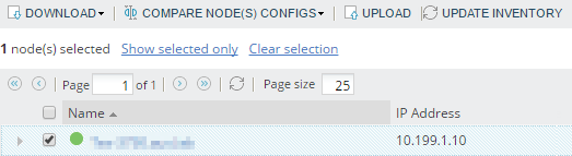

  2. Select the device and click Update Inventory.
  3. Click Yes at the confirmation prompt.

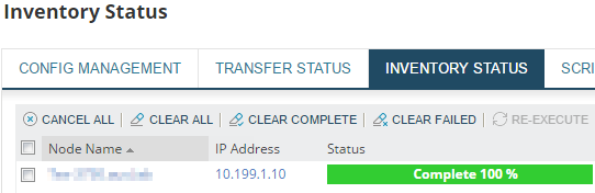

    When the inventory scan is complete, the progress bar reads Complete 100%.
