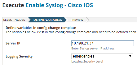

  4. Enter the IP address of the SolarWinds Platform server, and select a Severity level.
    You can choose any logging severity value.
  5. Click Next.

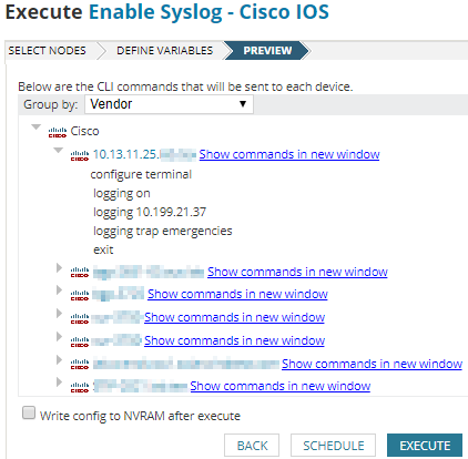

  6. After the system generates the script, you can expand any node to examine the commands. Then click Execute.
