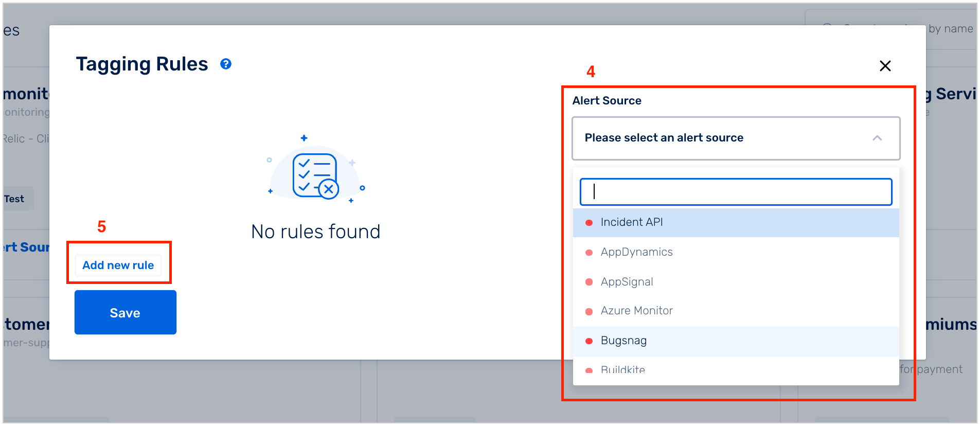

  1. Navigate to Services -> Service Overview -> select or search for your desired service.
  2. In the extreme right, expand the accordion -> In Automation section, View All
  3. In the Tagging Rules section, Add Tagging Rules
  4. Select an Alert Source from the drop down -> Add New Rule
  5. Event Tagging by alert source in Squadcast
  6. Tagging Rules can be added in three ways:

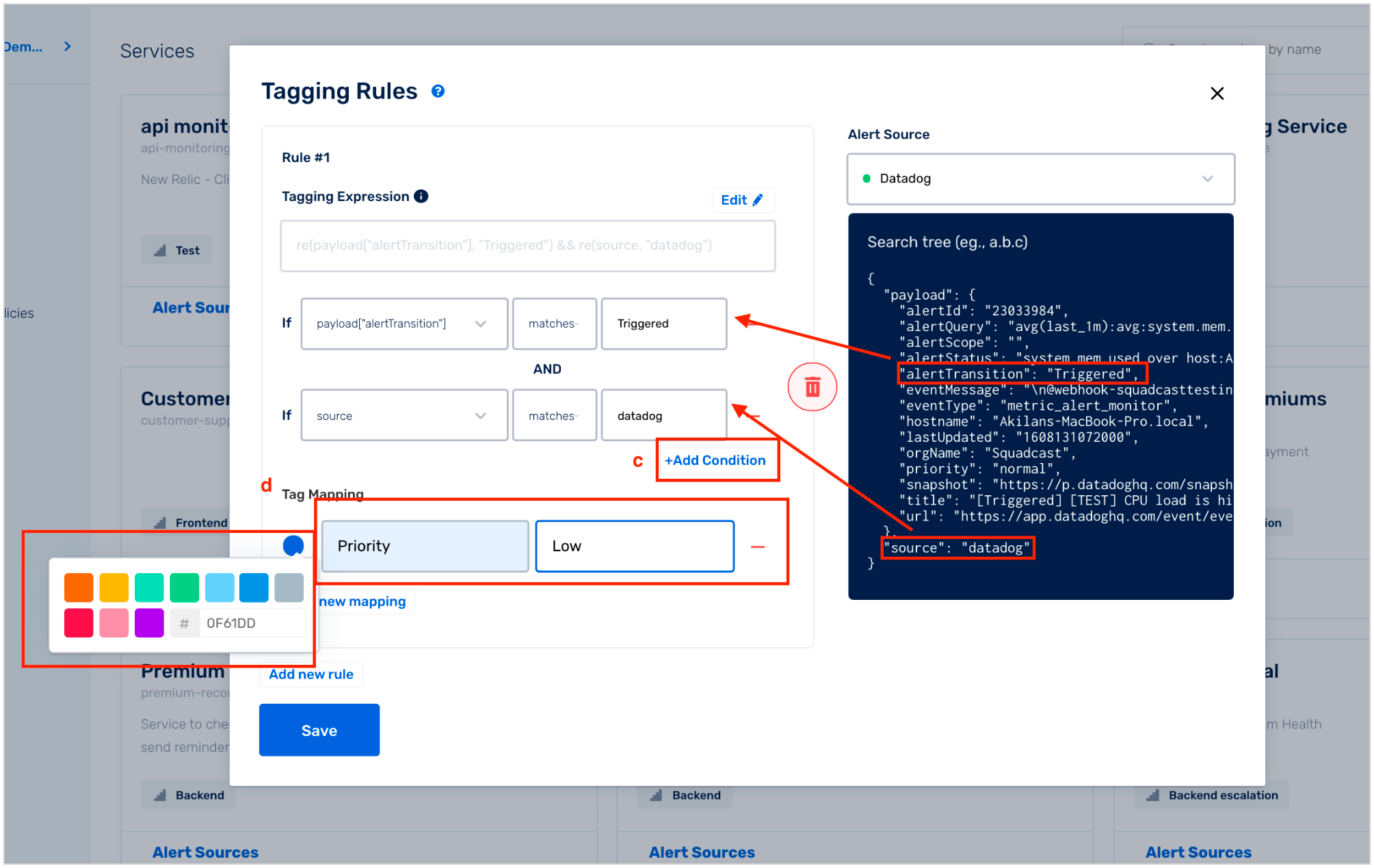

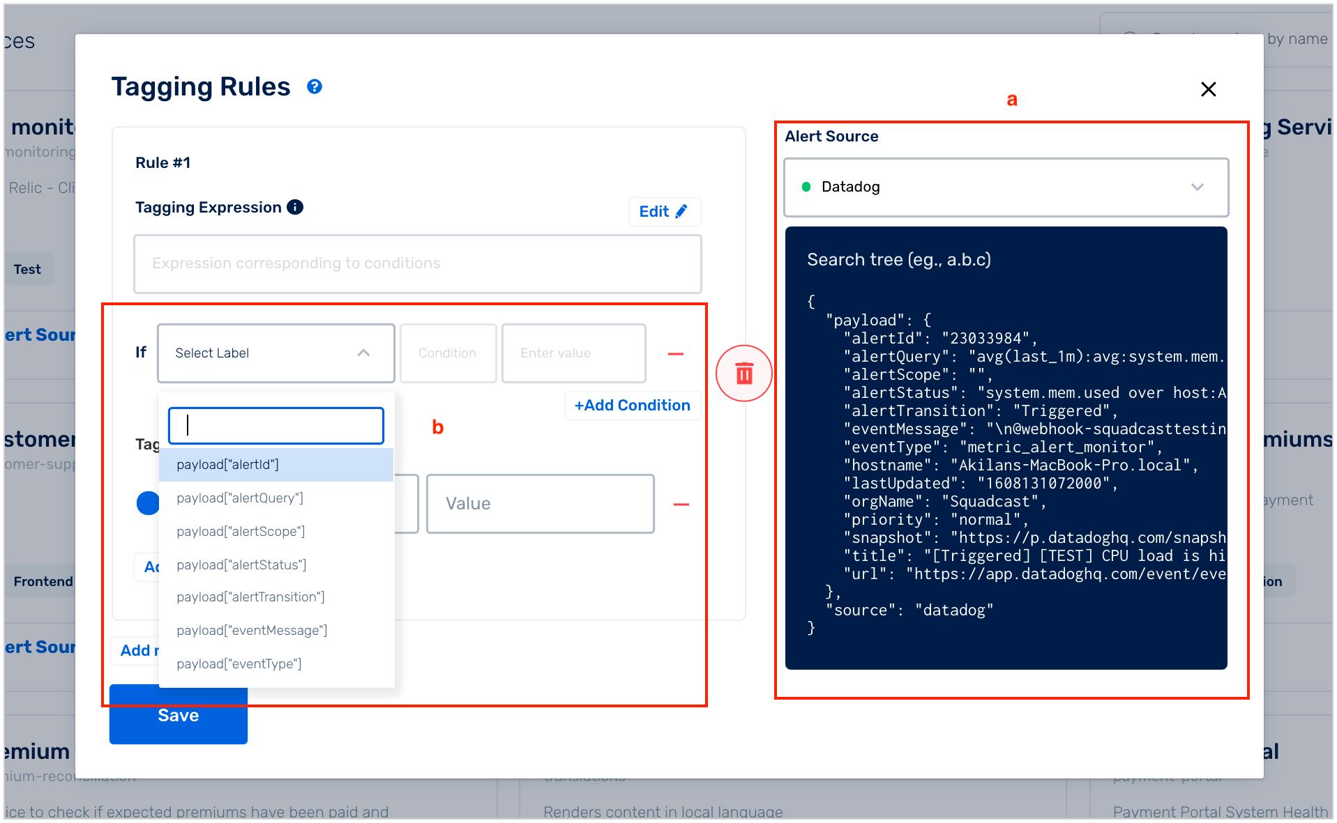

A. UI-based Rule Builder (Beginner-friendly)
a. On the right, you can view the payload of the latest alert for the chosen Alert Source
b. The drop-downs in the Rule Builder contain values from the payload on the right. You can use them to easily create your Tagging Rules

Add Event Tagging via UI-based Rule Builder
c. You can add more than 1 condition for a rule by selecting Add Condition (a logical AND is performed between all the conditions -> the entire Tagging Rule will evaluate to True only if all the conditions evaluate to True)
d. Map any Key and Value pair as a tag. Multiple tags can be defined for each rule. You can select different colours for each of your tags
Map a tag based on condition rule in Squadcast

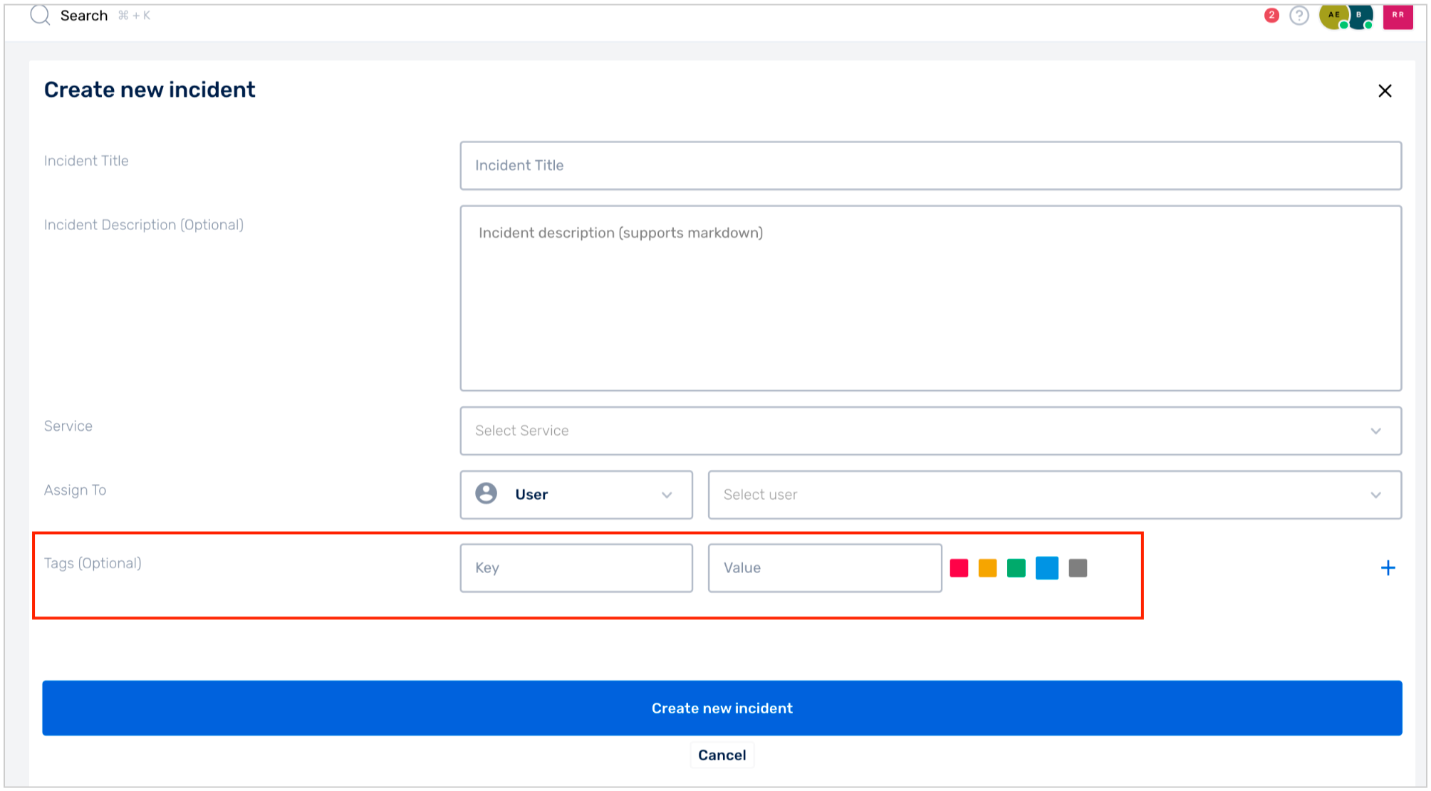

C. Manual Method
Associate a tag while creating an incident manually from the Incident Dashboard
Manual Method for tagging in manual incident in Squadcast

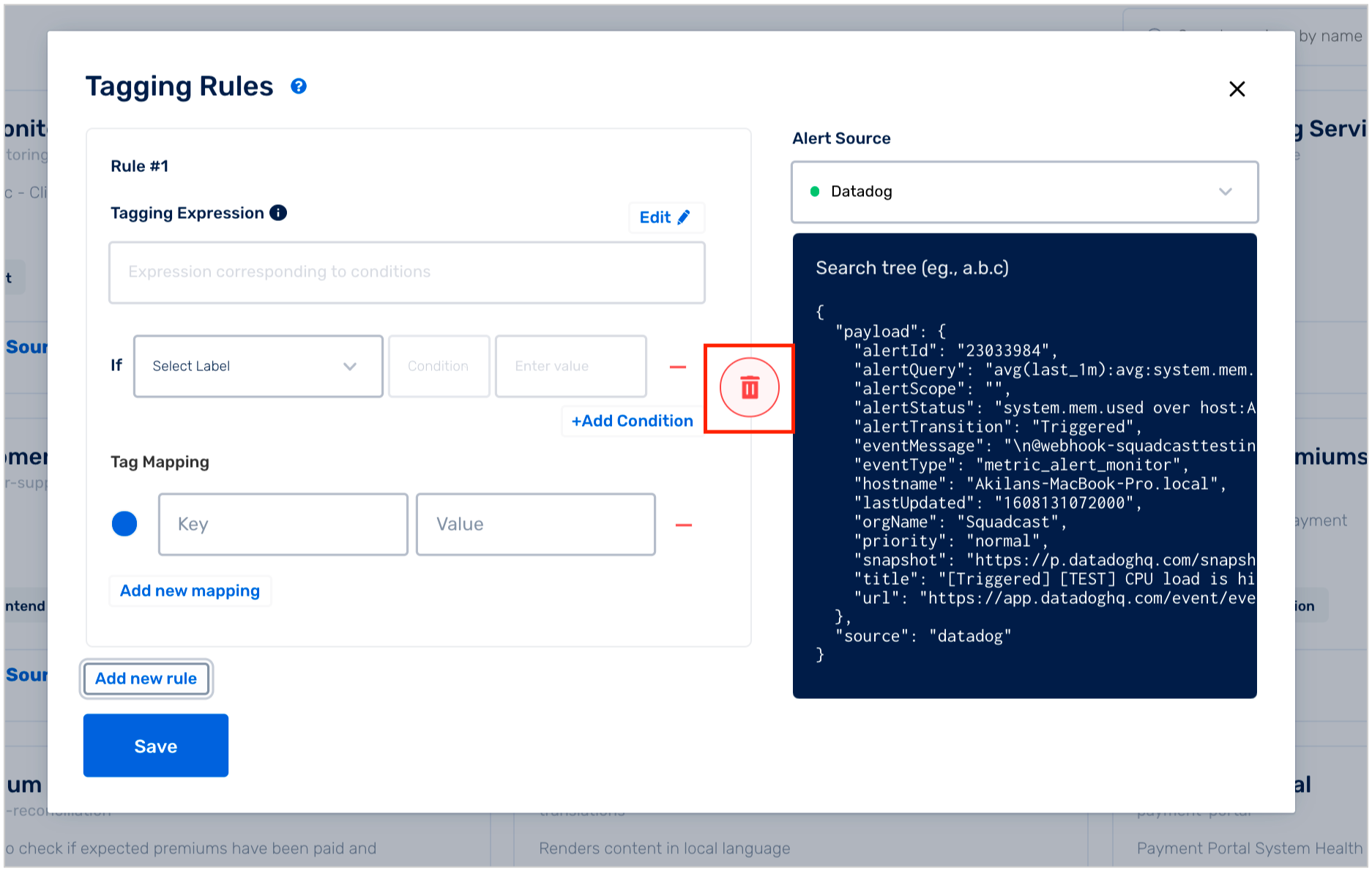

Deleting Tagging Rules
  1. Click on the Tagging Rule for a selected Service
  2. Click on the bin icon to delete that rule and click on Save

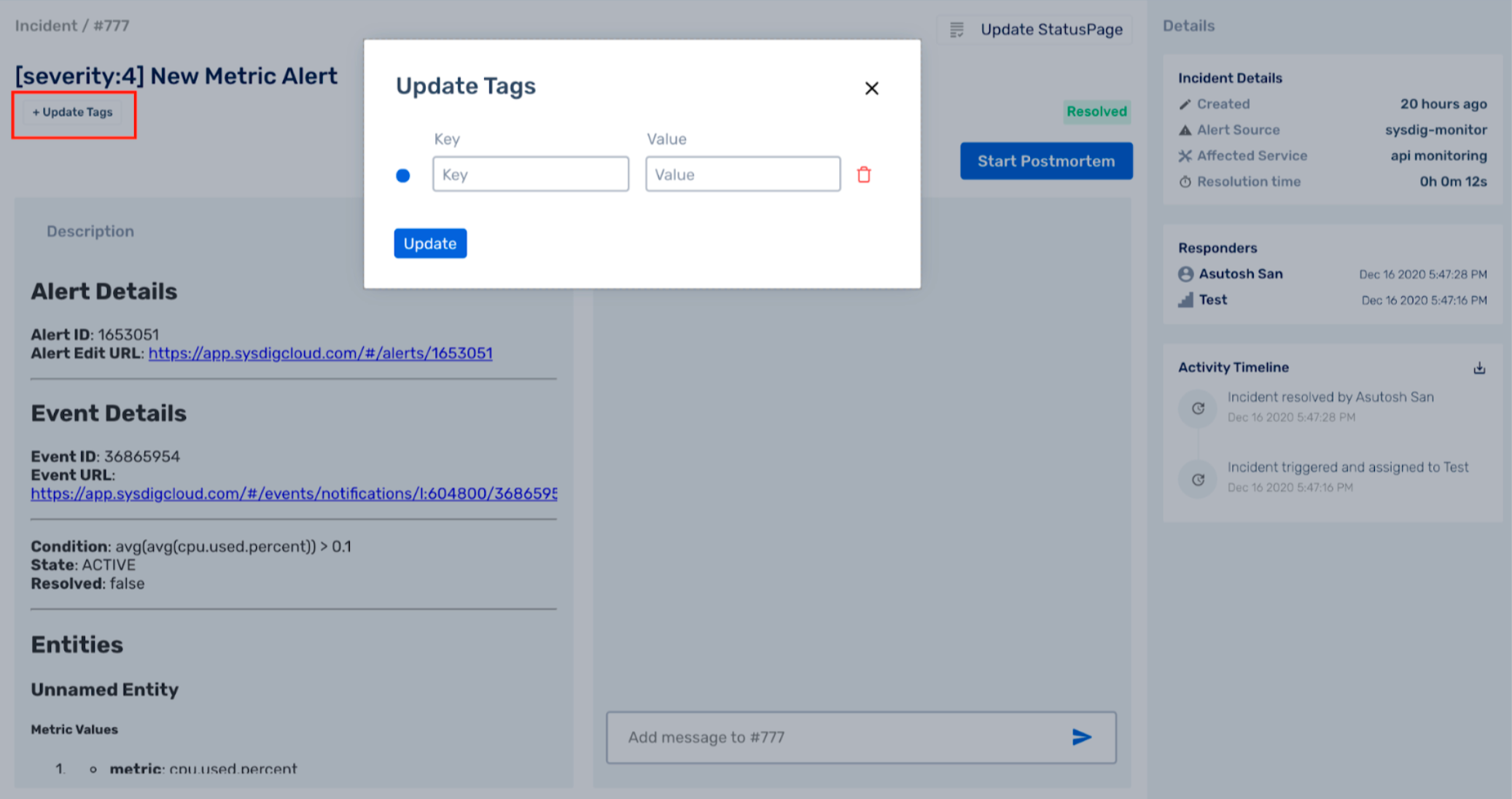

Updating Tags
Use +Update Tags within an incident to update tags for a specific incident

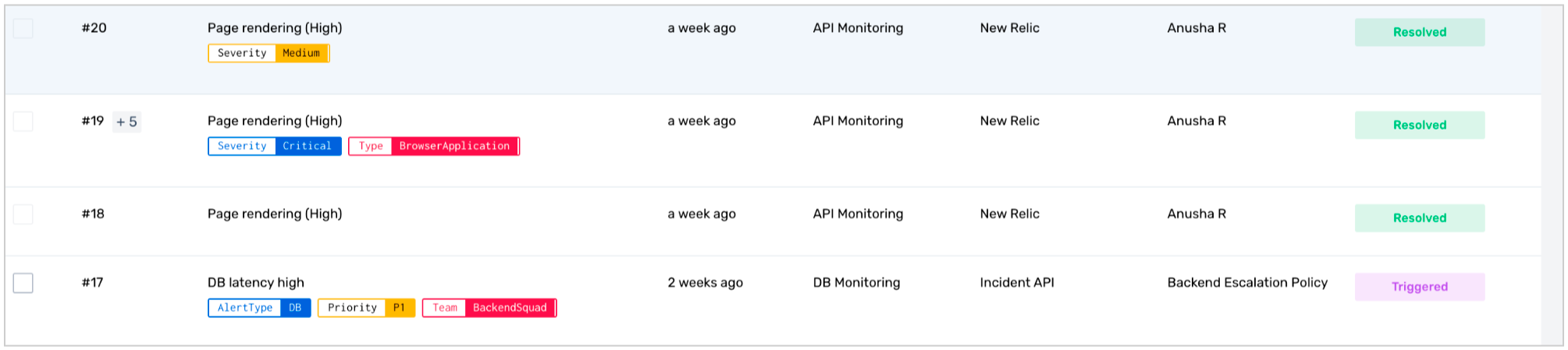

1. Where can I see the tags associated with incidents?
You will be able to clearly view tags associated with incidents in theIncident List.

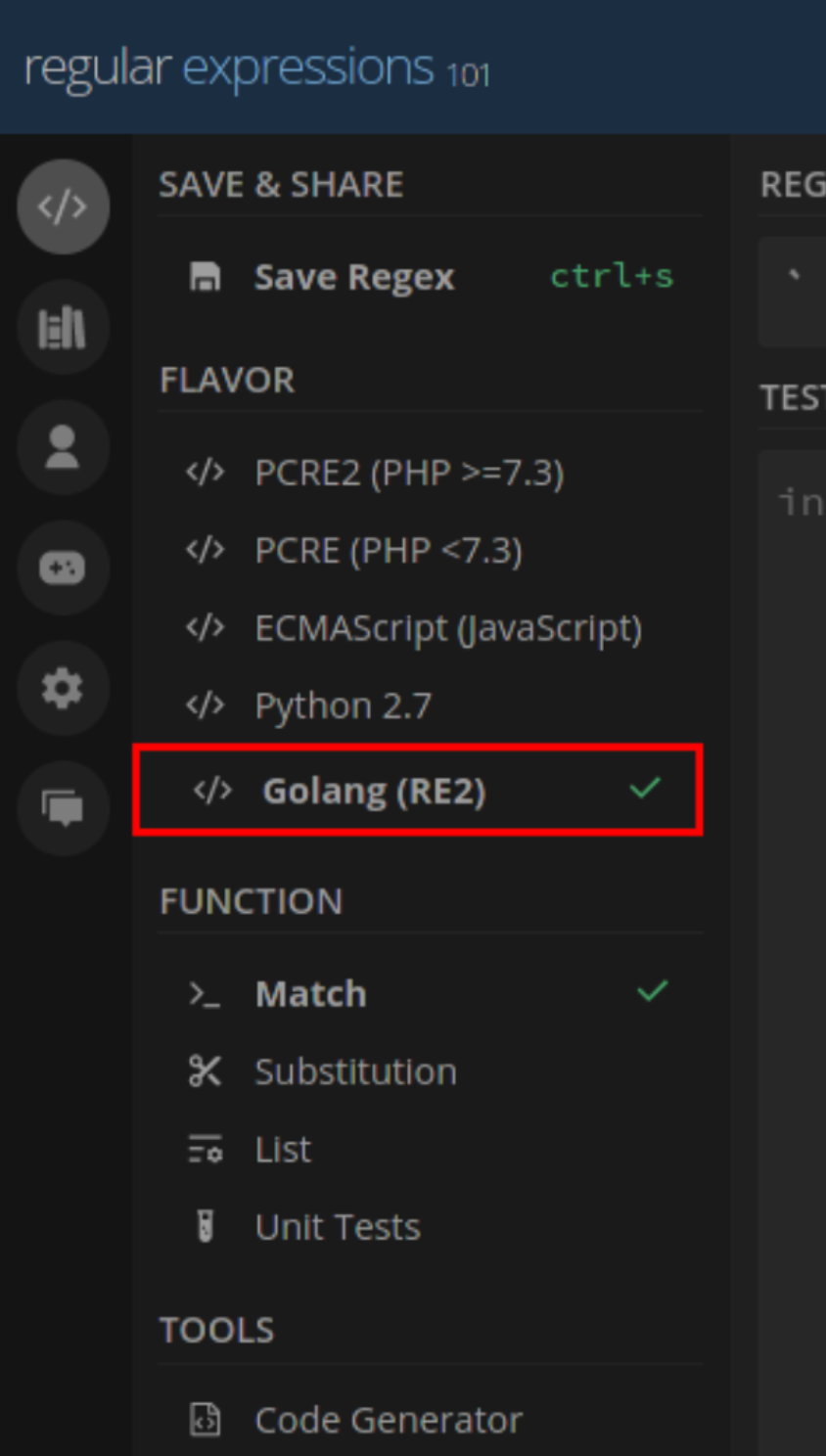

6. What kind of regex can be used to write custom rules?
The rule engine supports expressions with parameters, arithmetic, logical, and string operations. You can also check this out to get an idea of all the expression types accepted in Incident Response. Please do your regex here against Golang flavor as shown in the screenshot below and then, set them up in Incident Response:
