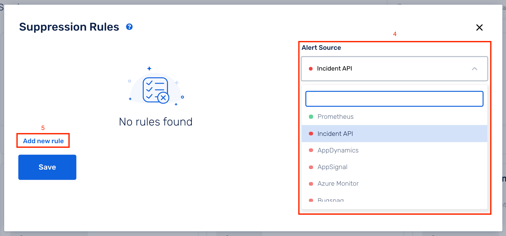

Create Alert Suppression Rules
  1. Navigate to Services -> Service Overview -> select or search for your desired service.
  2. In the extreme right, expand the accordion -> In Automation section, View All.
  3. In the Suppression Rules section, Add Suppression Rules.
  4. Select an Alert Source from the drop down -> Add New Rule.
  5. how to create alert suppression rules in Squadcast

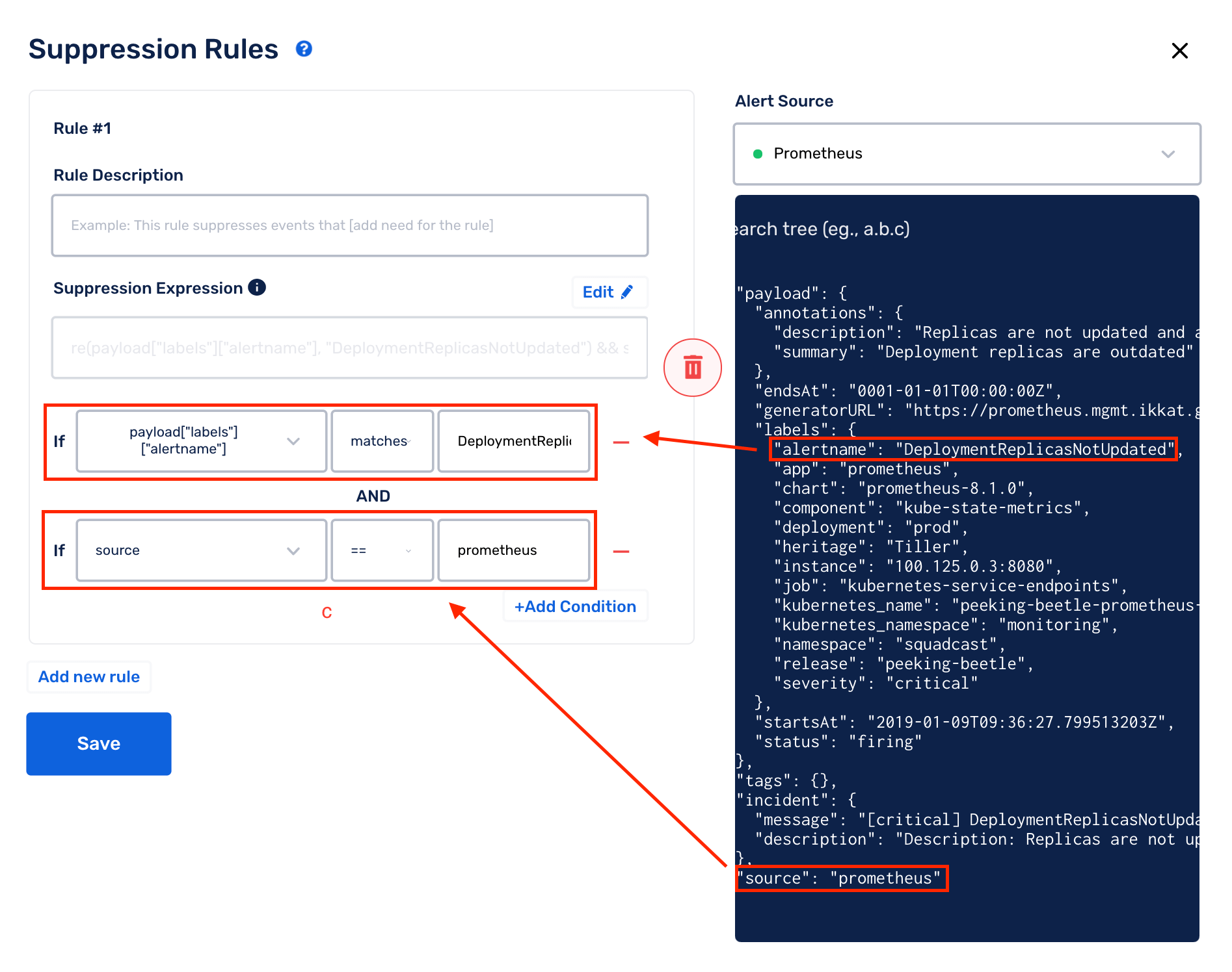

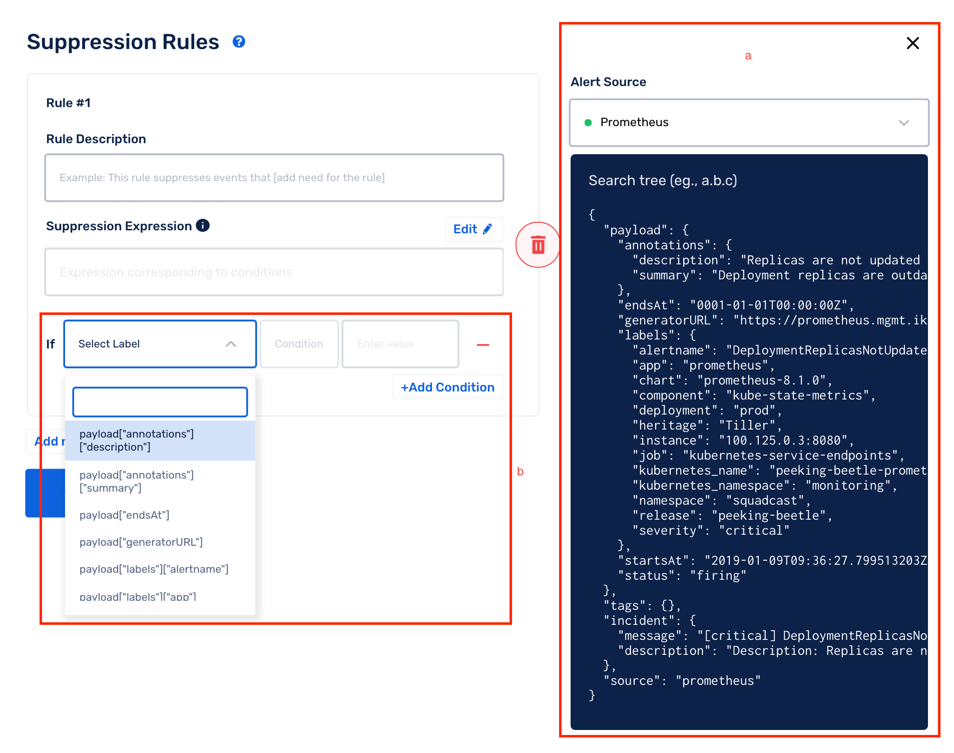

UI-based Rule Builder (Beginner-friendly)
  1. On the right, you can view the payload of the latest alert for the chosen Alert Source
  2. The drop-downs in the Rule Builder contain values from the payload on the right. You can use them to easily create your Suppression Rules. As you build the expression from these drop-downs, you can also see the corresponding raw string being auto-populated for the same under String Expression.
  3. You can create Suppression Rules using the following conditions:
    Operators Condition
    == if the payload value is equal to the given value
    != if the payload value is not equal to the given value
    matches/contains if the payload value matches (***or** contains*) the given value
    does not contain if the payload value does not contain the given value
    All these operators are case-sensitive.
    If you want to make the rules case insensitive, then you have to do it with the regular expression method.
    create your Alert Suppression Rules via UI-based Rule Builder in Squadcast
  4. You can add more than 1 condition for a rule by selecting Add Condition (a logical AND is performed between all the conditions -> the entire Suppression Rule will evaluate to True only if all the conditions evaluate to True)
  5. The drop-down blocks only support the logical AND operator between 2 expressions. If you want to have a logical OR operation between 2 expressions, then you would have to create a new Suppression Rule.

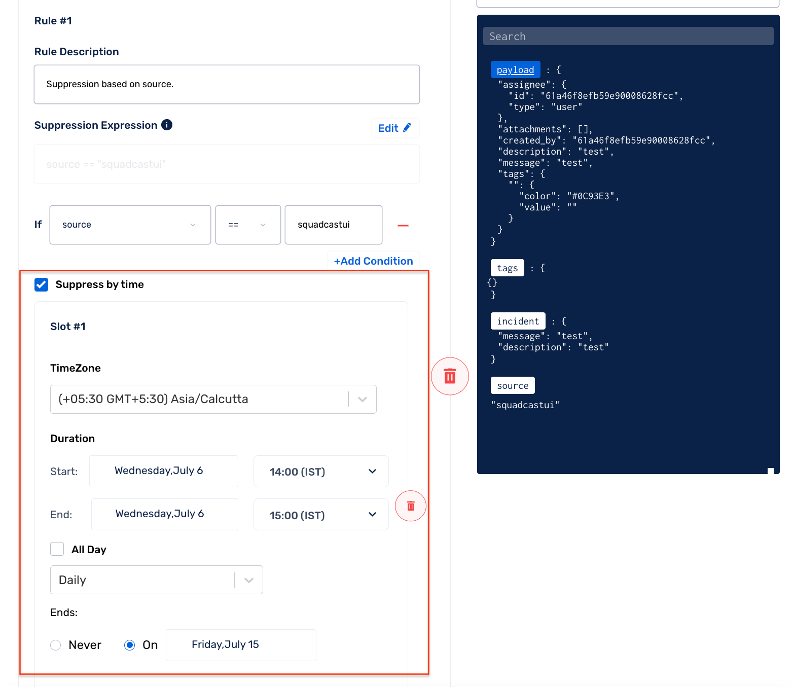

  6. You can suppress incidents based on time as well. To do so, check to Suppress by time. Add details for your suppression time slots like Timezone, Duration and Repetition.
  7. Under Duration, you can specify Start and End Dates and choose Start and End Time as well or simply run it for the entire day.
    You can add Repetition for your slot, to do so, you can choose from the drop-down list, while specifying the end for this repetition, as a particular date/time or never.
    You can add multiple suppression time slots for a single Suppression Rule.
    Users can select a timezone as per which the time slot needs to be active.

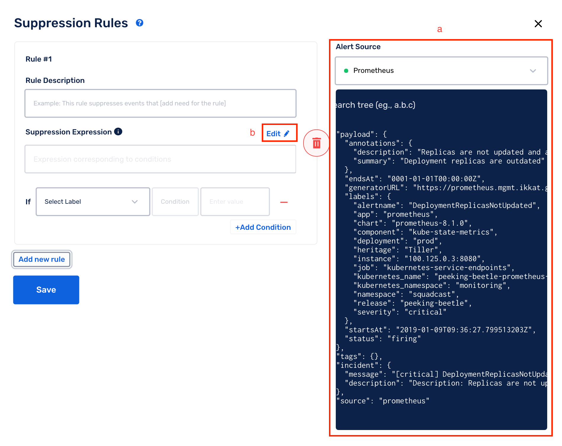

Raw String Method
Once you opt for the Raw String method, you cannot revert to the UI-based Rule Builder method.
  1. On the right, you can view the payload of the latest alert for the chosen Alert Source.
  2. Click on Edit to enable the Raw String method.
    Edit Alert Suppression Rules in Squadcast
  3. Write your custom Suppression Rule expression

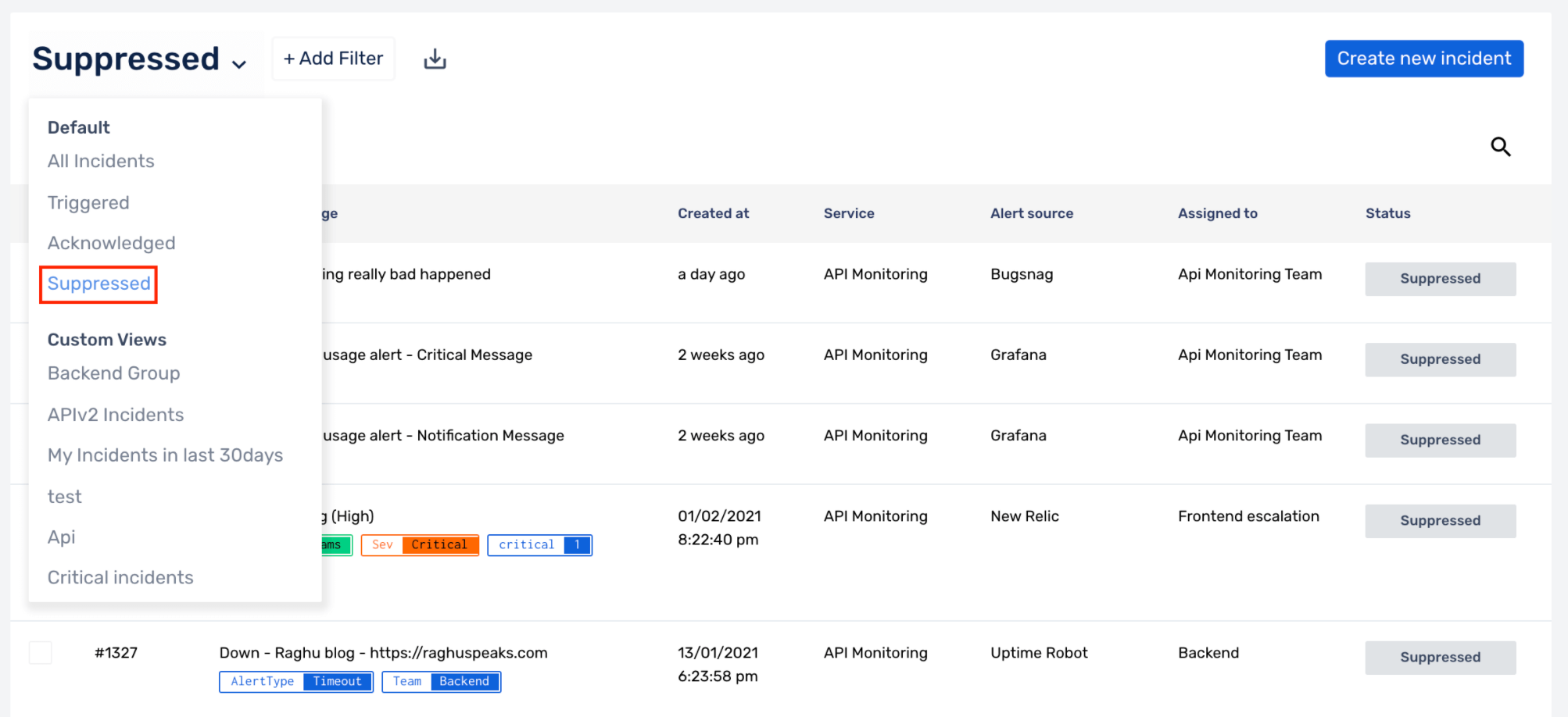

Viewing Suppressed Incidents
You can view suppressed incidents on the Incidents page by clicking on All Incidents and choosing Suppressed as highlighted in the screenshot below.
how to view Suppressed Incidents in Squadcast
  • Suppressed and Resolved are the final states for incidents in Incident Response. You will not be able to take any action on incidents that are in these states.
  • Incident information will be available on the Incident Response platform even if they are suppressed.

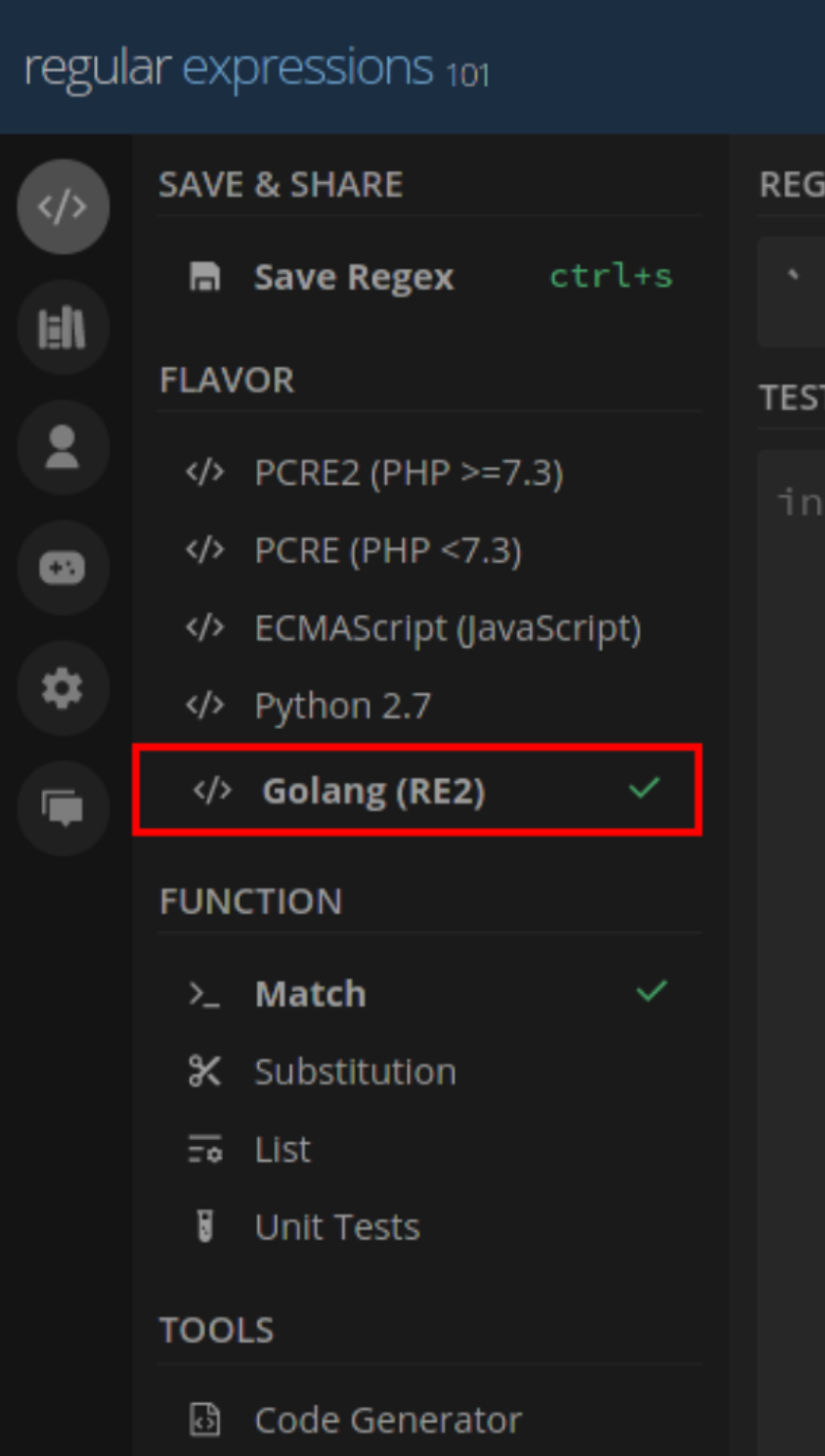

What kind of regex can be used to write custom rules?
The rule engine supports expressions with parameters, arithmetic, logical, and string operations. You can also check this out to get an idea of all the expression types accepted in Incident Response. Please do your regex here against Golang flavour as shown in the screenshot below and then, set them up in Incident Response:
Regex used to write custom rules

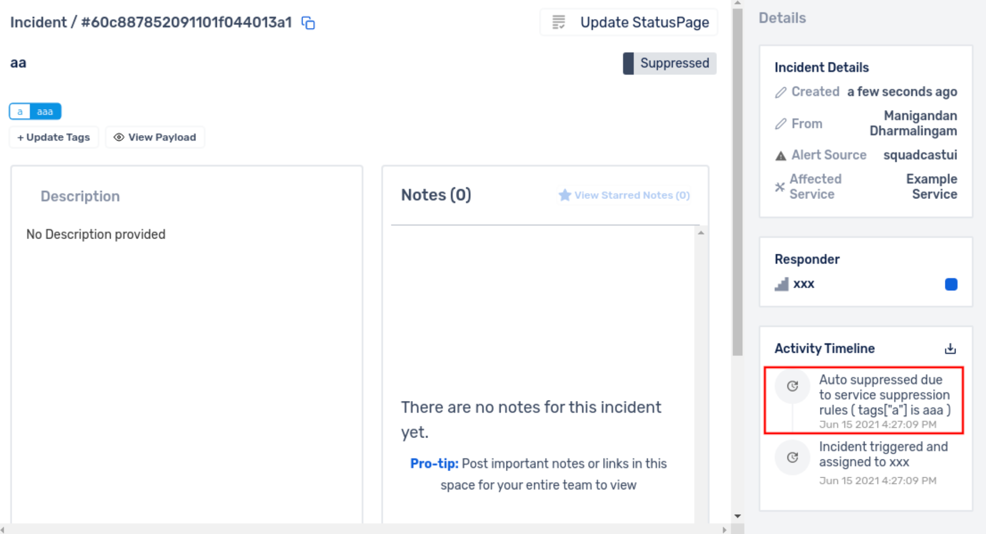

How do I know if an incident gets suppressed due to a Suppression Rule?
In the Incident’s Activity Timeline, the reason for suppression is displayed.
