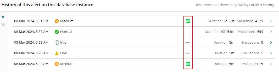

Indication that the notification was forwarded
To confirm that an alert notification was forwarded to ServiceNow or PagerDuty, view the alert history.
  1. From the DPA menu in the upper-right corner, click Alerts.
    The Current alert status page shows information about DPA alerts that are currently active.
  2. Click the name of the alert. The Alert details page opens.
  3. Scroll down to the History of this alert on this database instance page.
    A PagerDuty or ServiceNow icon is displayed for notifications that were forwarded to a notification service.
