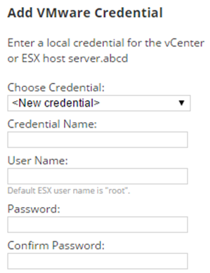

                                    On the Virtualization panel, to discover VMware vCenter or ESX hosts on your network: -
                                            Check Poll for VMware, and click Add vCenter or ESX Credential.
                                            Select <New credential> and provide required information. If you do not add the host credentials, the virtual machines (VMs) on the host are still discovered. However, you will not be able to see the relationships mapped between the VMs and hosts.

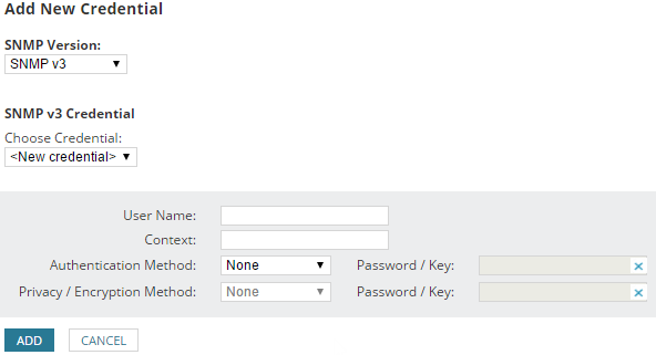

                                    On the SNMP panel: -
                                            If all devices on your network require only the default SNMPv1 and SNMPv2 public and private community stings, click Next.
                                            If any device on your network uses a community string other than public or private, or if you want to use an SNMPv3 credential, click Add Credential and provide the required information.

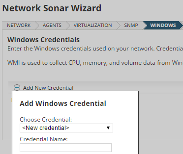

                                    On the Windows panel, to discover WMI or RPC-enabled Windows devices, click Add New Credential and provide the required information. SolarWinds recommends that you monitor Windows devices with WMI instead of SNMP.

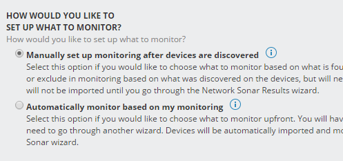

                                    On the Monitoring Settings panel, SolarWinds recommends manually setting up monitoring the first time you run discovery. This allows you to review the list of discovered objects and select the ones you want to monitor. When you scale monitoring, you can configure discovery to automatically start monitoring objects it finds.

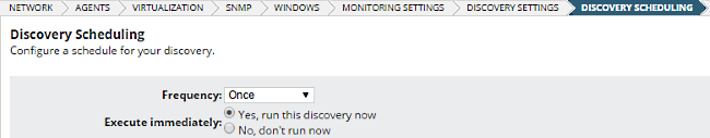

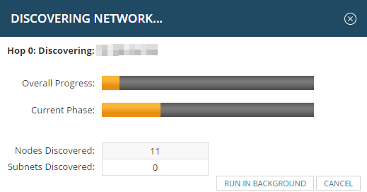

                                    Accept the default frequency and run the discovery immediately.   Discovery can take anywhere from a few minutes to a few hours, depending on the number of network elements the system discovers.
