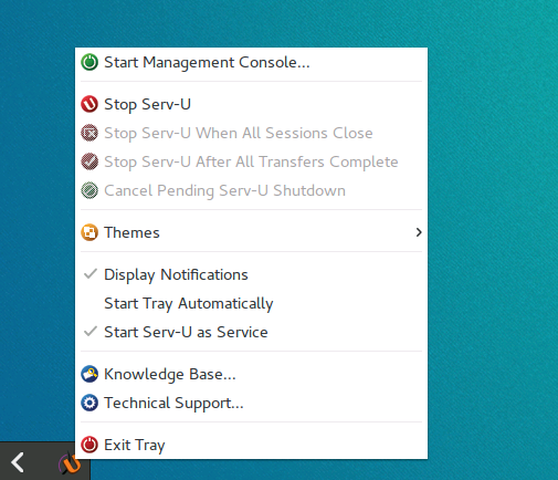

The Serv-U Tray application
The Serv-U Tray application is a GUI tool to start or stop the Serv-U MFT. The Tray application also provides options to enable display notifications, set up or remove Serv-U as a service, and open help topics.
There are two ways to implement the Tray application, depending on the UI Linux subsystem installed on your platform:
  • If GTK2 is installed, as is usually the case for KDE and the GNOME Linux UI system, you can use the gtk_status_icon_new call to create an icon object. (See the Common\RhinoUTIL\RhinoAshTray.cpp CRhinoAshTray::PutOnAshTray method.)
  • If libappindicator is installed, as may be the case for KDE, Unity Linux UI subsystem, you can use it to create a tray icon. (See Common\RhinoOSAL\LibAppIndicator.)

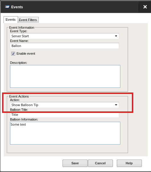

Balloon Tip notifications
By design, Serv-U does not have a GUI inside it; instead, all balloon notifications are displayed by the Serv-U Tray application as part of server events notification. Thus, the Tray application must be started to display balloon tip notifications.
