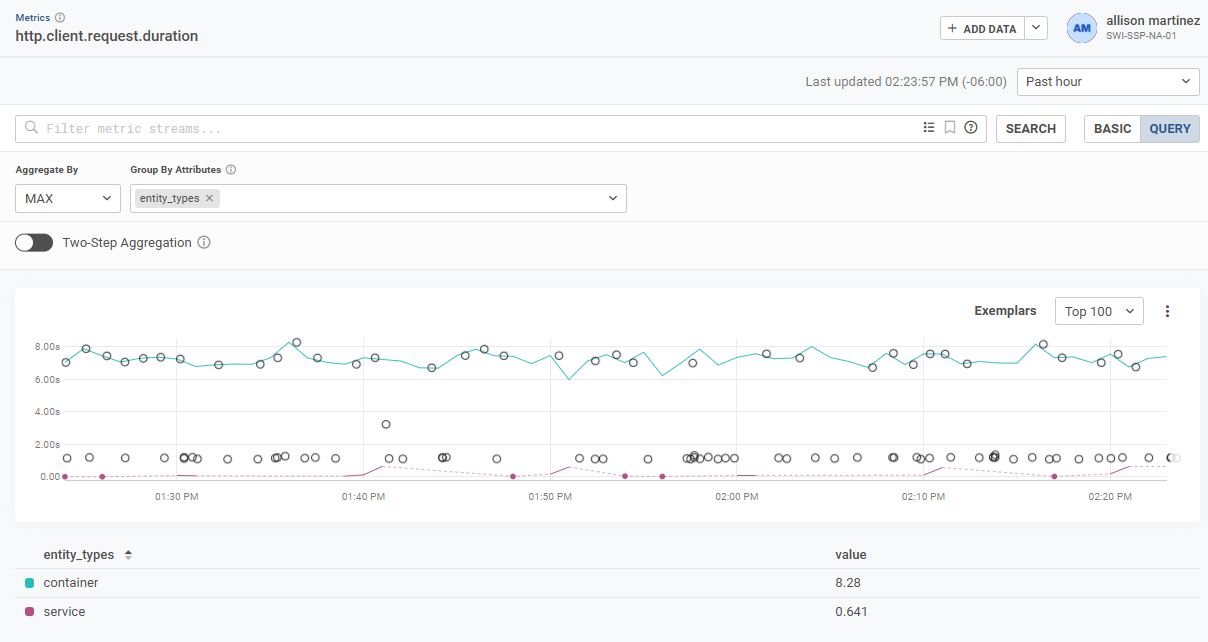

This image shows exemplars enabled for a MAX aggregated metric, grouped by the entity_types attribute. Exemplars are indicated by a small circle icon. The sample size is the Top 100 exemplars.

To view exemplars in the Metrics Explorer, search for and select the metric of interest. Then use the three-dot menu above the chart to toggle on the exemplars overlay and view them alongside your metrics chart. If accessing from Metrics tab in the Service Details view, the exemplars will be enabled by default when the metric contains exemplar annotations (otherwise, the toggle remains disabled and grayed-out).
Enabling exemplars also enables the drop down menu to change the sample of exemplars that are displayed.
  • Top N exemplars: Displays exemplars limited to N based on highest metric values.

In the example above, the sample in this image comprises the Top 100. Changing the way the data is aggregated using the tools above the chart on the upper left will update the view of the relationship between the exemplars plotted and the selected metric. Exemplars are represented by a circle icon.
This image shows the open three-dot menu with the Exemplars option toggled on. The default sample selected is the Top 100 exemplars.

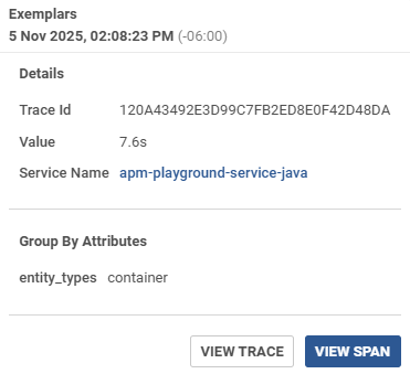

Hovering over an exemplar annotation opens a context modal window that shows the timestamp and key details such as the value recorded, Service Name, and Trace ID. Here, you can open the related trace or span details to seamlessly move from aggregated metrics to detailed trace data during investigations into performance issues.
This image shows the context modal window that appears when hovering over an exemplar annotation, displaying timestamp, value, Service Name, and Trace ID.
