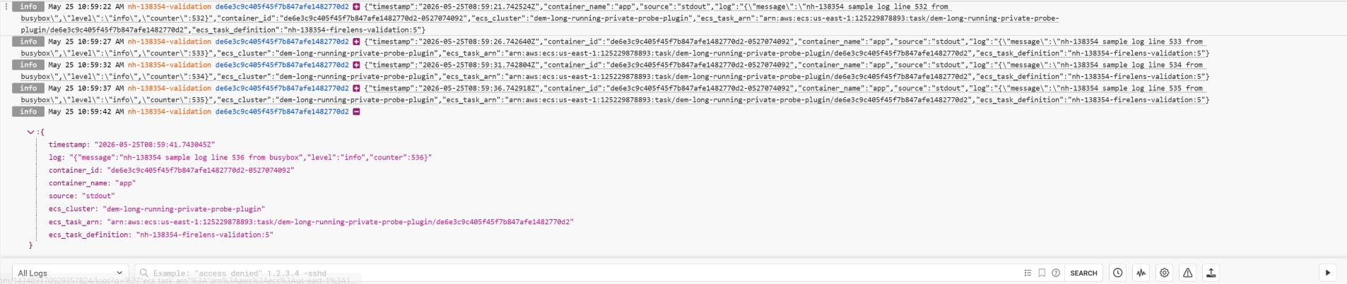

Step 3: Verify the logs
In SolarWinds Observability SaaS, confirm that the logs are searchable with the ECS service name as the hostname and the ECS task ID as the program value: host:checkout-api program:<ECS_TASK_ID>.
Records arrive as JSON objects, not bare log lines. The application message is stored in the log field, with ECS metadata in the same object. A record has the following structure:
"timestamp": "2026-08-20T07:59:04.249644Z",
"container_id": "<container-id>",
"container_name": "app",
"source": "stdout",
"log": "Example application log message",
"ecs_cluster": "<ecs-cluster>",
"ecs_task_arn": "arn:aws:ecs:<region>:<account-id>:task/<cluster>/<task-id>",
"ecs_task_definition": "<family>:<revision>"
The ECS task ID is available in the program field from the X-Otel-Resource-Attr header.
