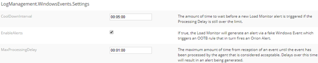

The alert criteria are established in the Global Advanced Configuration settings under LogManagement.WindowsEvents.Settings.
Administrators can adjust the following:
  • Cool down interval: The amount of time to wait before a new Load Monitor alert triggers if the processing delay is still over the limit.
  • Enable alerts: Select the check box to enable alerts.

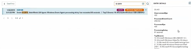

  • Max processing delay: The maximum amount of time from the reception of an event until the event has been processed by the agent.
The event log displays specific event data in the Entry Details pane, such as the number of unprocessed events and the delay time.
