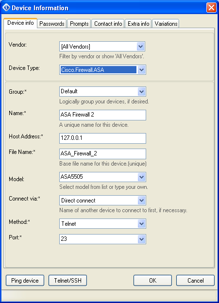

The Generic.Device script is a basic script designed to be a starting point for the use of variations. However, some of the other scripts also support the use of variations. In the device information panel a variations tab is available if the device supports variations. You can access the variations GUI via the Variations tab.
Overview of how to use variations
To use variations on a specific device a variations file for that device must be placed in the \Program Files (x86)\CatTools3\Variations sub folder of the CatTools install directory. The variations file must be named the same as the Device File Name in the CatTools Device Information > Device info pane. The file must have a .txt extension.
For example if your device was Generic Device 1 with a File Name of Generic_Device_1 your variations file would be called Generic_Device_1.txt. You can manually create this file using notepad or you can use the variations GUI.
