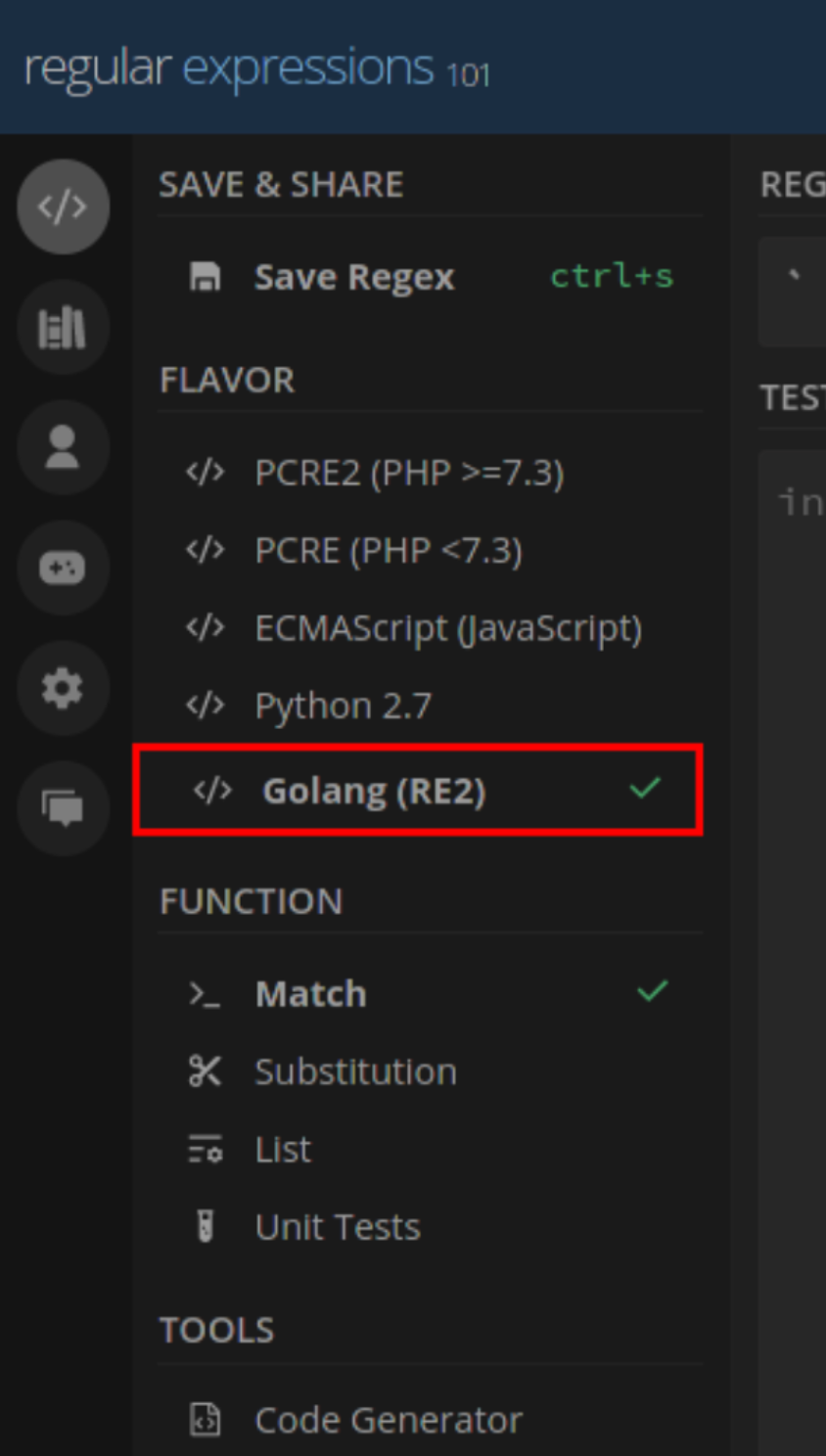

The rule engine supports expressions with parameters, arithmetic, logical, and string operations. You can also check this out to get an idea of all the expression types accepted in Incident Response. Please do your regex here against Golang flavor as shown in the screenshot below and then, set them up in Incident Response:
Regex used to write custom rules in Squadcast
