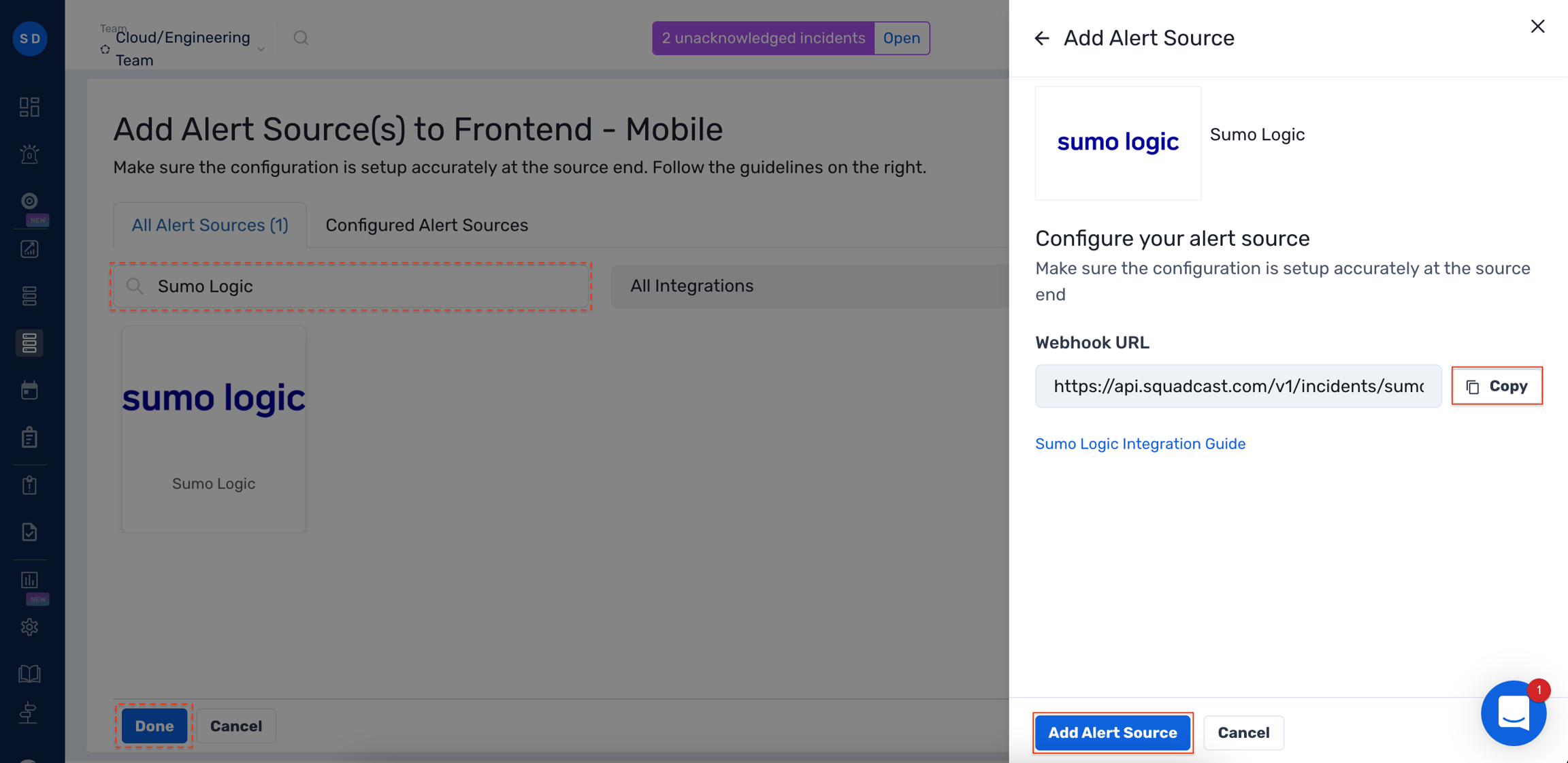

Navigate to Services -> Service Overview -> select or search for your Service. Expand the accordion -> In the Alert Sources section, click Add.
Select Sumo Logic. Copy the displayed Webhook URL to configure it within Sumo Logic. Finish by clicking Add Alert Source -> Done.
When an alert source turns Active, it’ll show up under Configured Alert Sources, you can either generate a test alert from the integration or wait for a real-time alert to be generated by the Alert Source. An Alert Source is active if there is a recorded incident via that Alert Source for the Service.

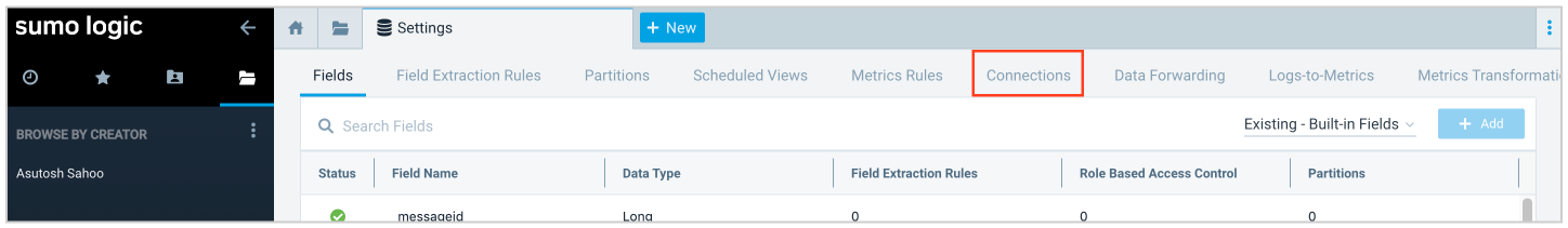

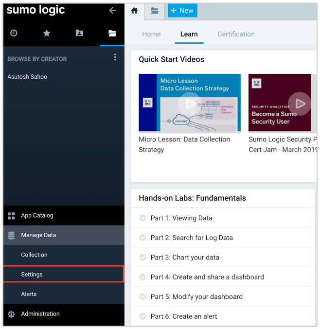

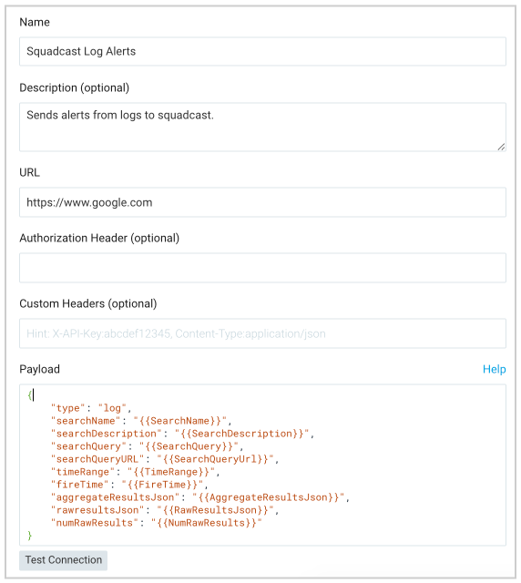

Login to your sumo logic dashboard and go to the Settings tab in the Manage Data section.
Select the Connections tab from the topbar.

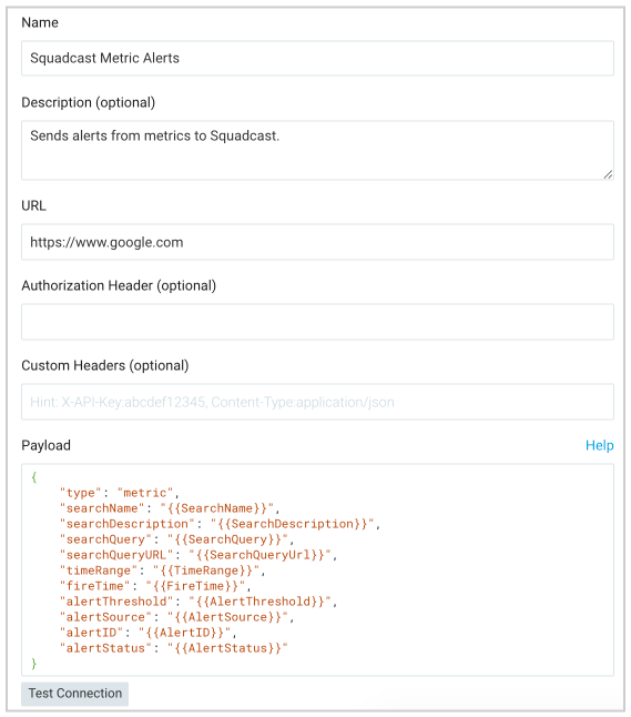

Click on + button.
Select Webhook option.
Add the Log Alerts webhook connection.
Paste the webhook URL copied from the Incident Response dashboard in the URL field.
In the payload field, past the following
"type": "log",
"searchName": "{{SearchName}}",
"searchDescription": "{{SearchDescription}}",
"searchQuery": "{{SearchQuery}}",
"searchQueryURL": "{{SearchQueryUrl}}",
"timeRange": "{{TimeRange}}",
"fireTime": "{{FireTime}}",
"aggregateResultsJson": "{{AggregateResultsJson}}",
"rawresultsJson": "{{RawResultsJson}}",
"numRawResults": "{{NumRawResults}}"
Similarly, add Metric Alerts webhook connection.
Paste the same webhook URL copied from the Incident Response dashboard in the URL field.
"type": "metric",
"alertThreshold": "{{AlertThreshold}}",
"alertSource": "{{AlertSource}}",
"alertID": "{{AlertID}}",
"alertStatus": "{{AlertStatus}}"

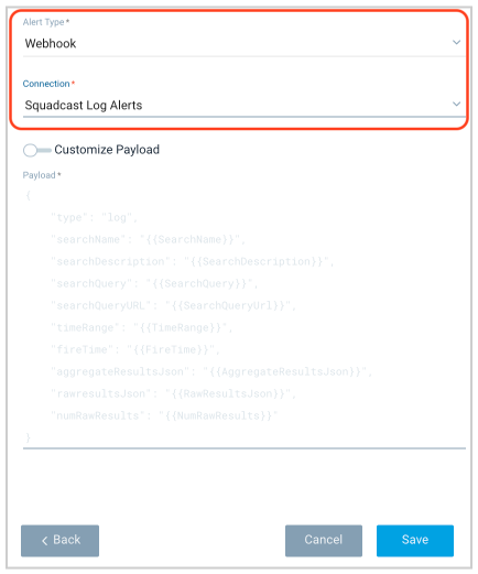

Setting up Alerting for Logs
Follow the article: Schedule Searches for Webhook Connections for configuring alerts for logs.
In the Alert Type drop-down, select Webhook.
In the Connection drop-down, select Incident Response Log Alerts.

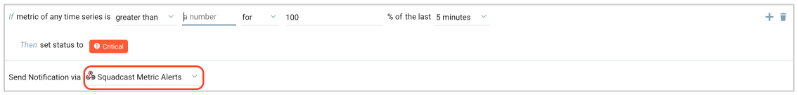

Setting up Alerting for Metrics
Refer the video: Monitor your Metrics in Real-Time with Sumo Logic Alerts for configuring alerts for Metrics.
In the Send Notification Via dropdown, select Incident Response Metric Alerts.
