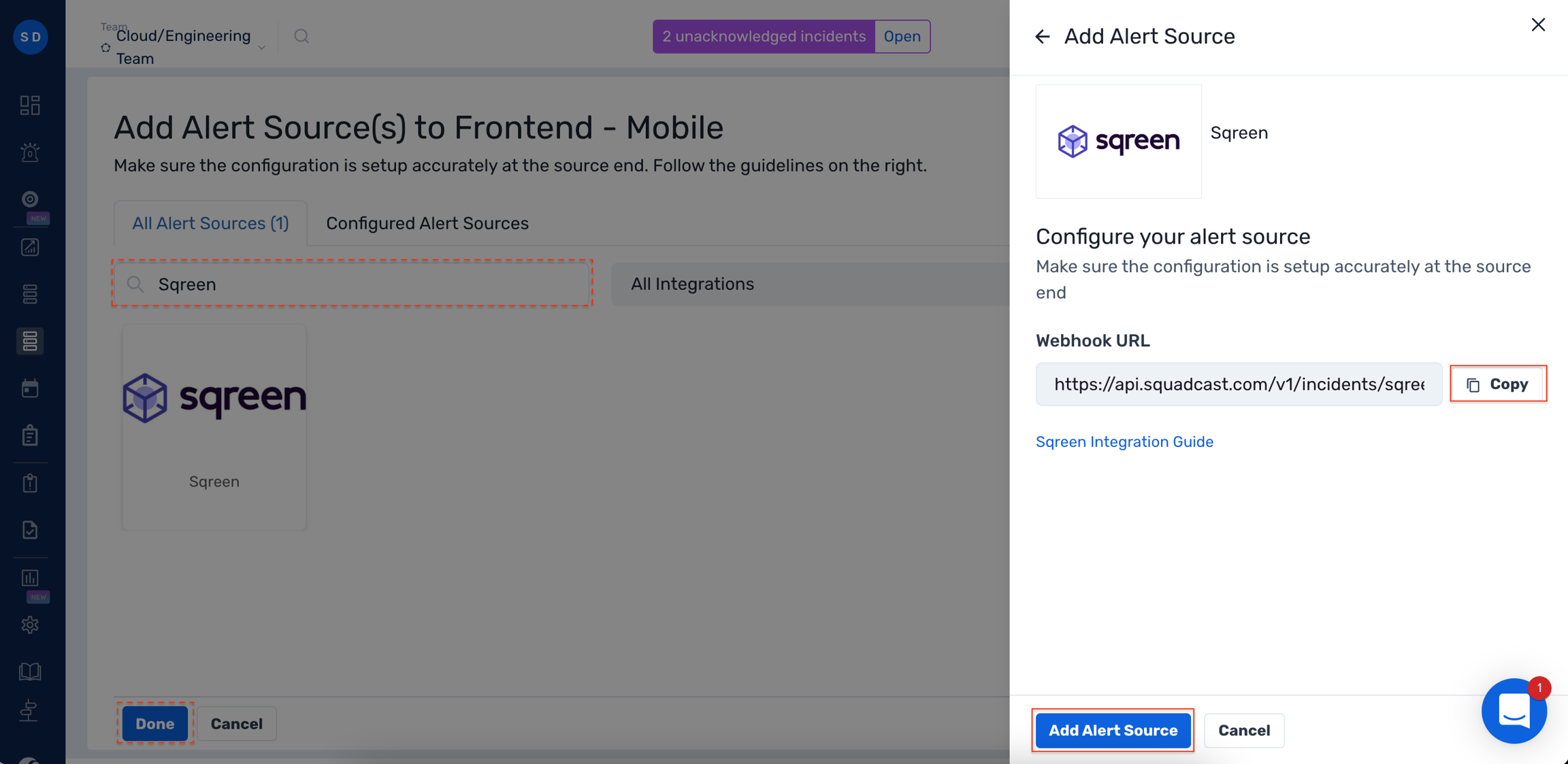

  2. Select Sqreen. Copy the displayed Webhook URL to configure it within Sqreen. Finish by clicking Add Alert Source -> Done.

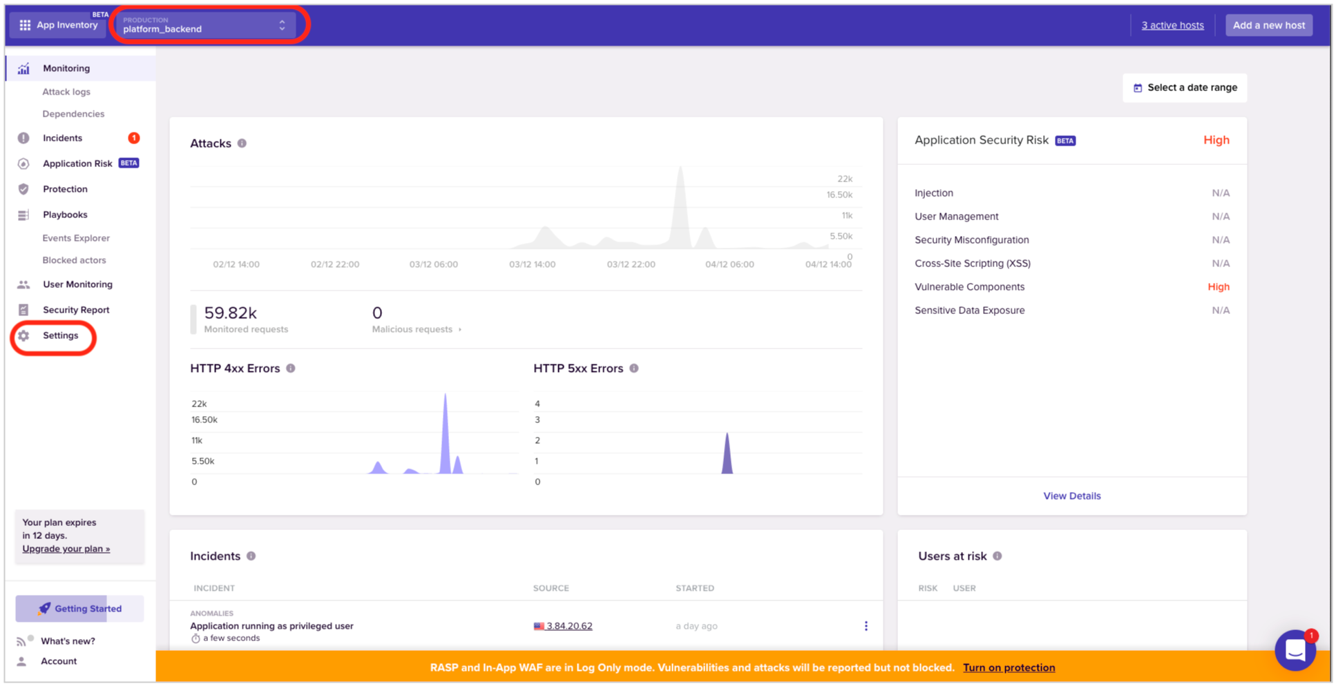

  1. Log in to Sqreen dashboard and select the the application you want to add webhook from the dropdown.
  2. And click the settings button

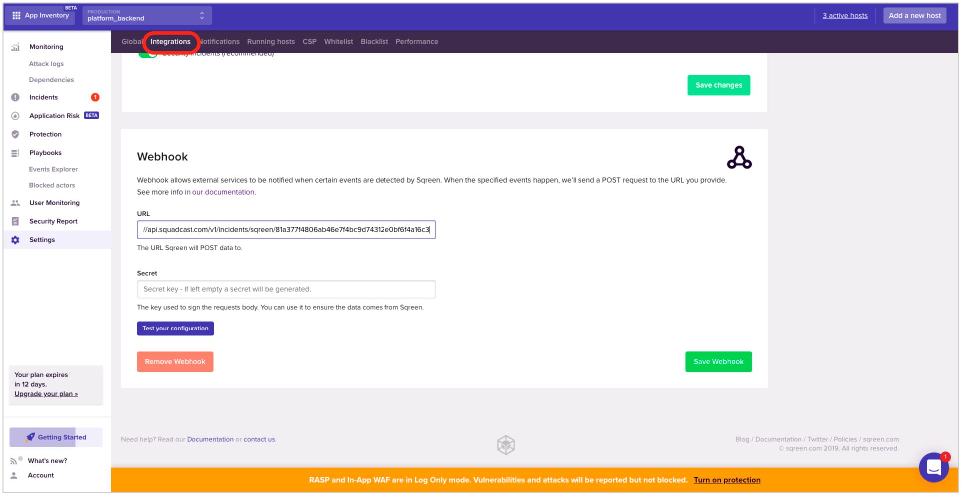

  3. Click on the Integrations tab.
  4. Come to down to the Webhook page and paste the Webhook URL in the URL text box and click on the Save Webhook button.
    Now you're all set & good to go.
  5. [Optional] You can now test your configuration by clicking on the Test your configuration button.
