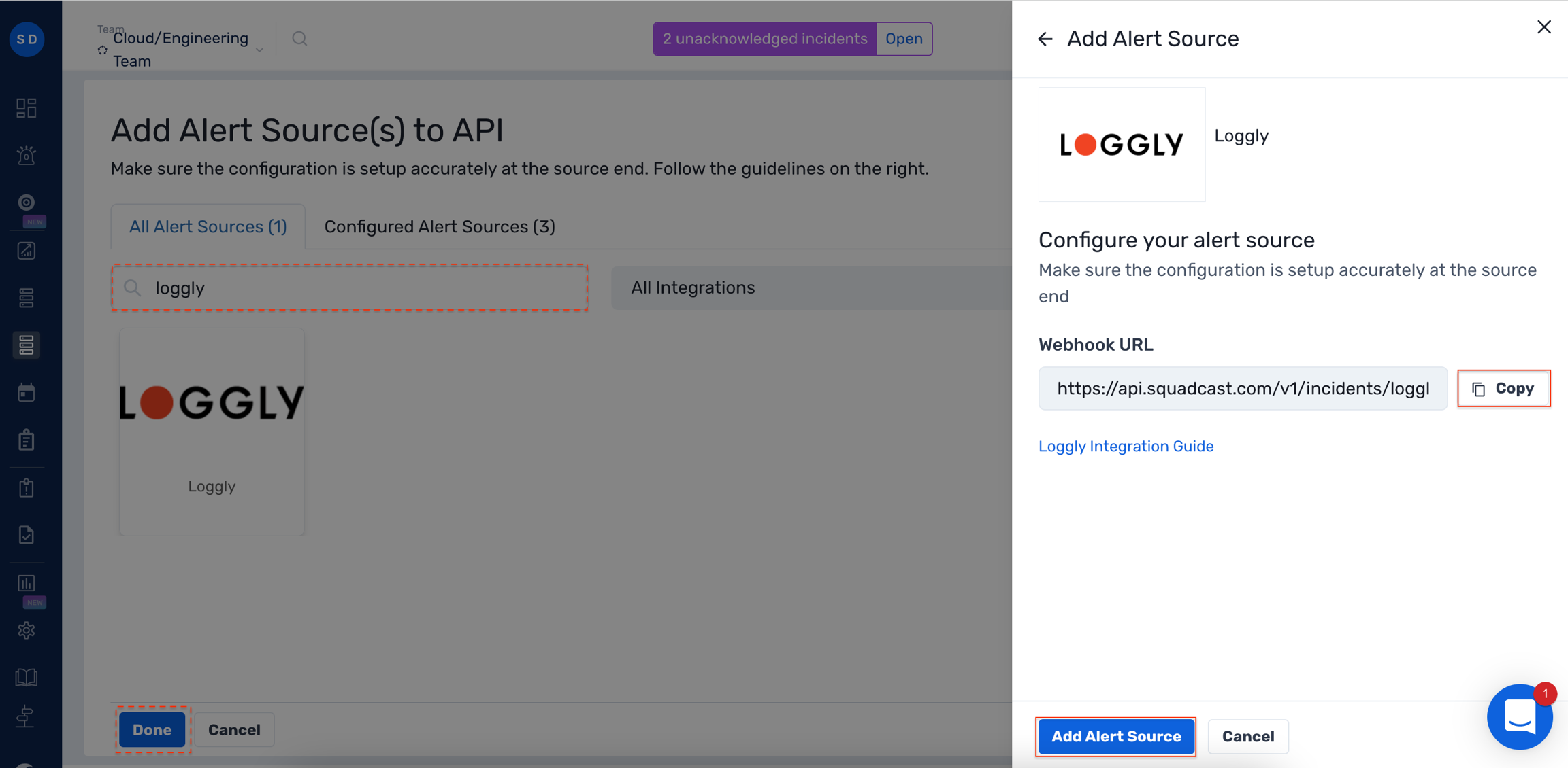

Using Loggly as an Alert Source in Incident Response
  2. Select Loggly. Copy the displayed Webhook URL to configure it within Loggly. Finish by clicking Add Alert Source -> Done.
When an alert source turns Active, it’ll show up under Configured Alert Sources, you can either generate a test alert from the integration or wait for a real-time alert to be generated by the Alert Source. An Alert Source is active if there is a recorded incident via that Alert Source for the Service.

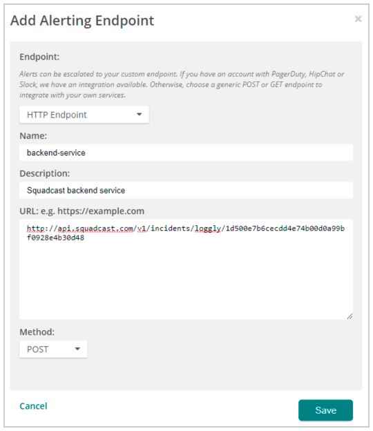

Now log in to your Loggly account and click on "Alerts".
On the alerts page click on "Alert Endpoints" and then click on "Create Endpoint"
Select the type as "HTTP Endpoint", method as "POST" and enter the URL obtained earlier.
Enter the appropriate name and description for your endpoint and click on Save.

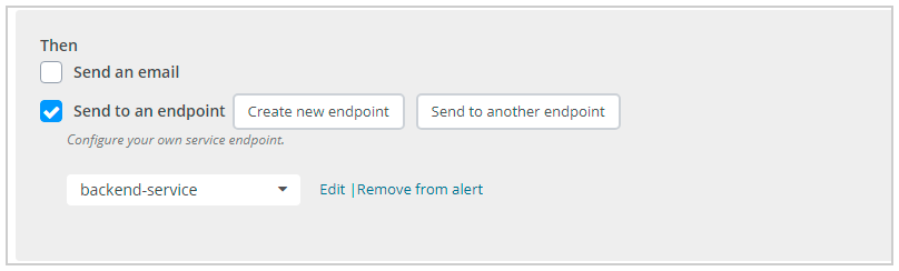

Now you can use this alert endpoint in any of yours alert configuration. Every time here an alert is triggered you will get a corresponding incident in squadcast.
