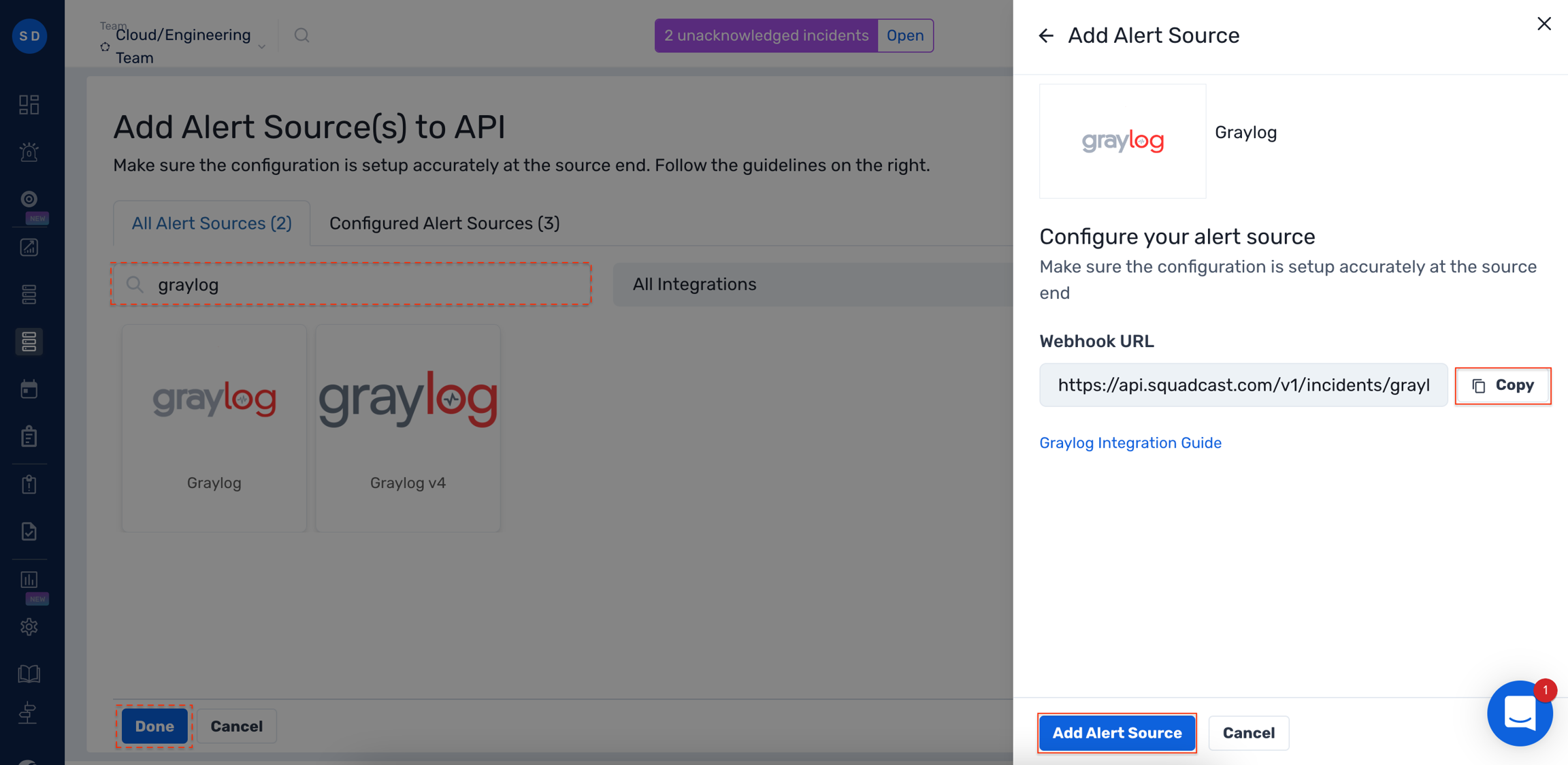

Follow the steps below to configure a service so as to extract its related alert data from Graylog.
Incident Response will then process this information to create incidents for this service as per your preferences.
Using Graylog as an Alert Source
  2. Select Graylog. Copy the displayed Webhook URL to configure it within Graylog. Finish by clicking Add Alert Source -> Done.
When an alert source turns Active, it’ll show up under Configured Alert Sources, you can either generate a test alert from the integration or wait for a real-time alert to be generated by the Alert Source. An Alert Source is active if there is a recorded incident via that Alert Source for the Service.

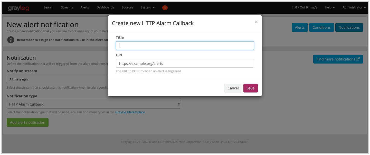

Create a Incident Response Webhook in Graylog
  1. Login to your graylog web console and go to Alert tab on the top.
  2. Click on Notifications.
  3. Click on Add new notification.
  4. Select All messages on Notify on Stream
  5. Select HTTP Alarm Callback on Notification type and click on Add alert notification.
  6. Give a title to the notification and put the Incident Response web hook url from the previous step on the url field and click on Save.
Now whenever an alert is triggered by Graylog, an incident will be created automatically in Incident Response.
