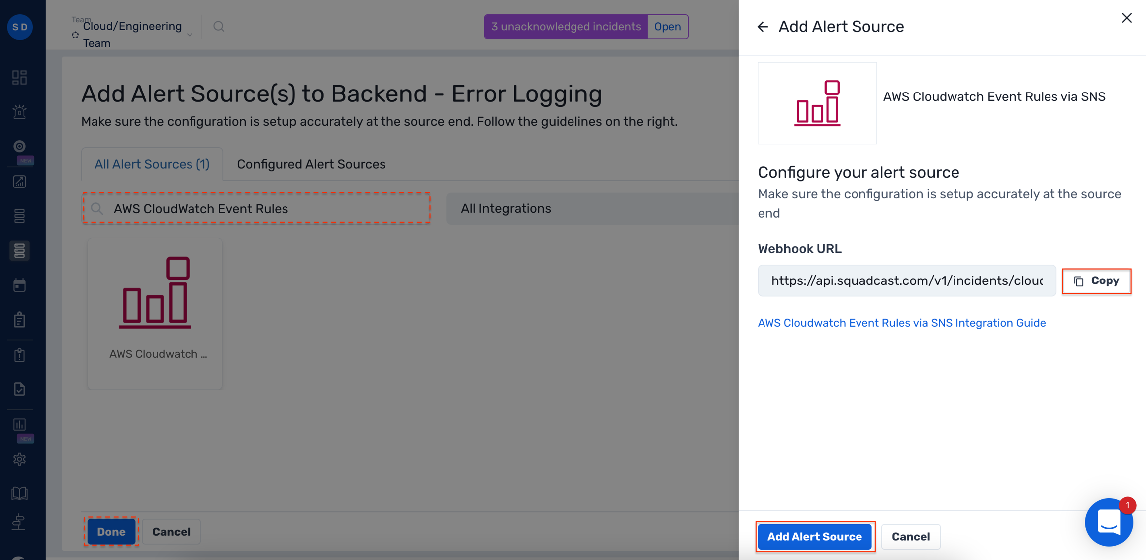

  2. Integration of Amazon CloudWatch Event Rules as alert source with Squadcast
  3. Select Amazon CloudWatch Event Rules. Copy the displayed Webhook URL to configure it within Amazon CloudWatch Event Rules. Finish by clicking Add Alert Source -> Done.
Webhook URL configuration within Amazon CloudWatch Event Rules in Squadcast
When an alert source turns Active, it’ll show up under Configured Alert Sources. You can either generate a test alert from the integration or wait for a real-time alert to be generated by the Alert Source.

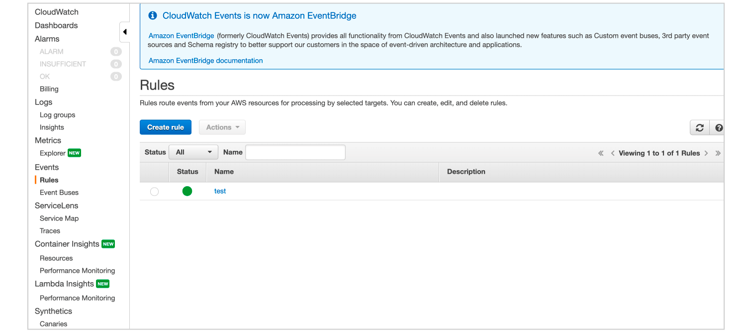

  1. Go to CloudWatch and click on Rules under Events
  2. Click on Create Rule
  3. Creating CloudWatch Event Rules in AWS

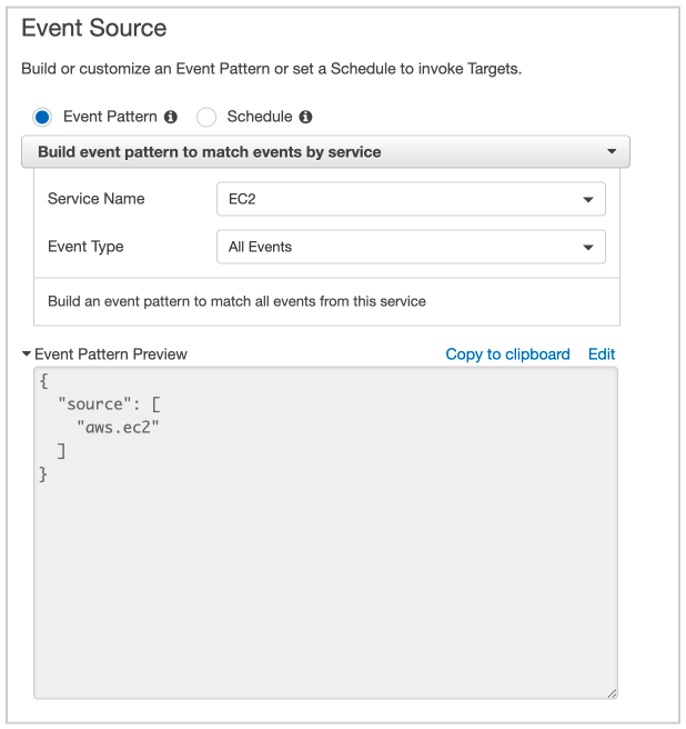

  4. Select desired Service Name and Event Type In this example, we're selecting Service Name: EC2 and Event Type: All Events
  5. Selecting Service Name and Event Type in CloudWatch Event Rules

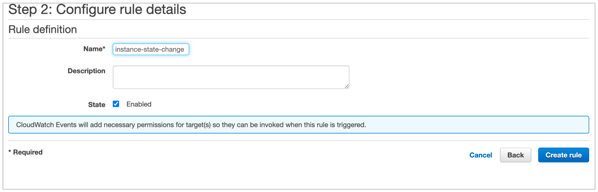

  9. Click on Configure rule details. Enter the name of your rule. Add a description as needed
  10. Click on Create a rule to save this configuration
Configuring Rule Details in CloudWatch Event Rules
