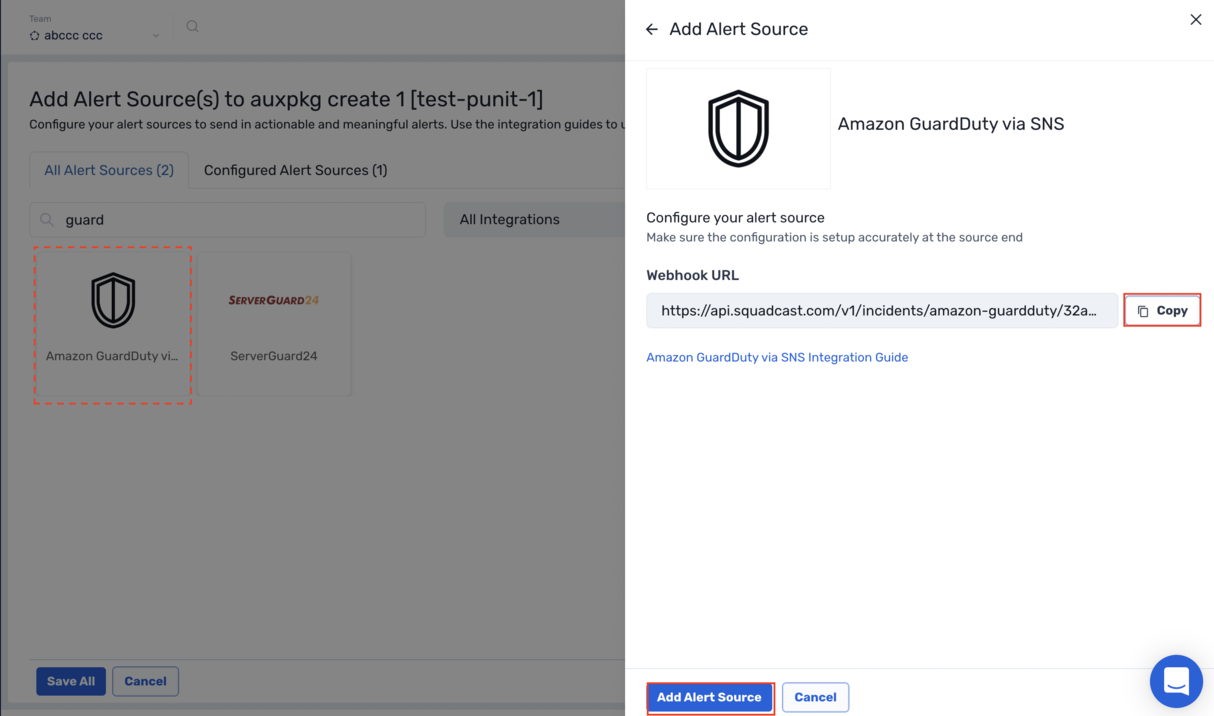

How to integrate Amazon GuardDuty with Incident Response
  2. Integration of Amazon GuardDuty with Squadcast
  3. Select Amazon GuardDuty. Copy the displayed Webhook URL to configure it within Amazon GuardDuty. Finish by clicking Add Alert Source -> Done.
Webhook URL configuration within Amazon GuardDuty
When an alert source turns Active, it’ll show up under Configured Alert Sources, you can either generate a test alert from the integration or wait for a real-time alert to be generated by the Alert Source.
An Alert Source is active if there is a recorded incident via that Alert Source for the Service.

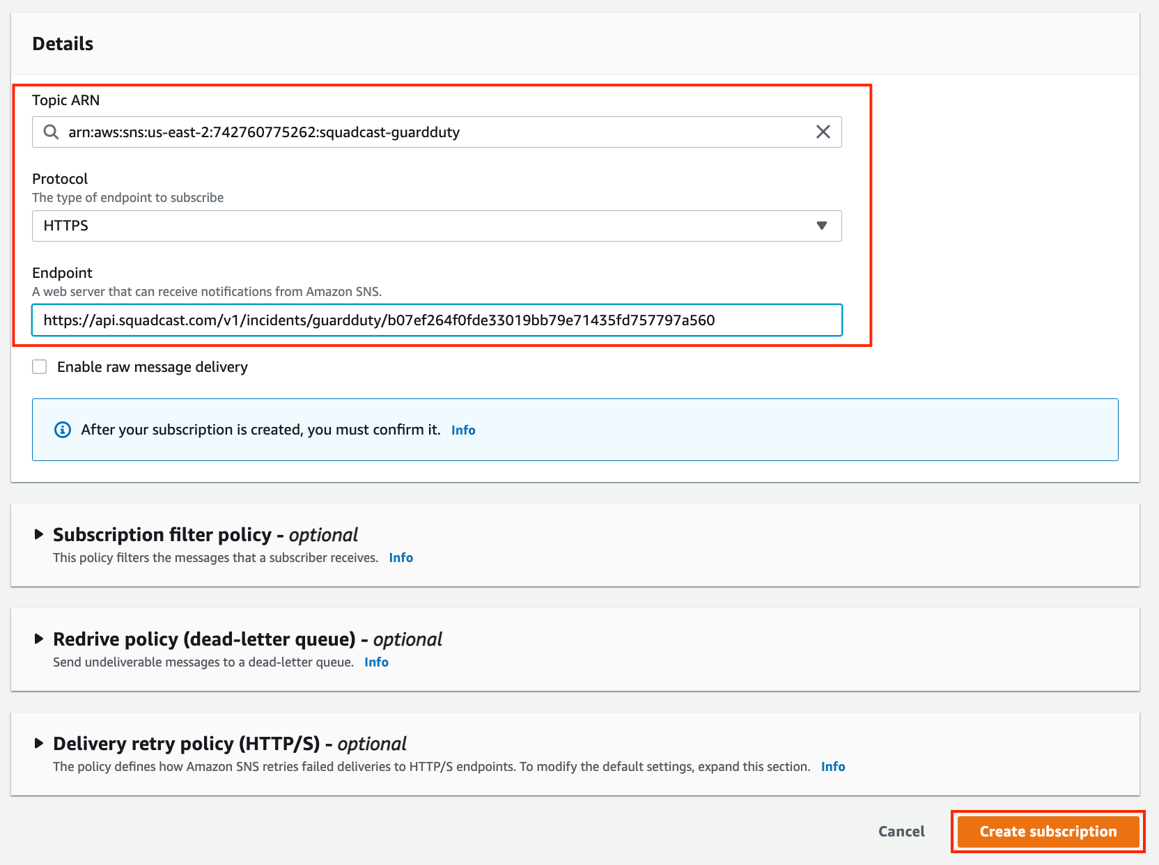

  7. Select the protocol as HTTPS and in the endpoint enter the URL you obtained from the previous step.
  8. Finally, click on Create Subscription to create the subscription
Select the protocol as HTTPS and in the endpoint to configuration
The Subscription ID for the subscription should immediately change to Confirmed from PendingConfirmation. Click on the refresh button to verify the same.

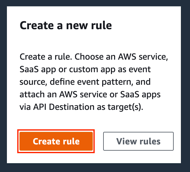

  4. Select Rules from the left menu, then click Create Rule. One or more rules can be created to send specific events to Incident Response when a GuardDuty finding is opened
  5. Configure GuardDuty in AWS - Create rules

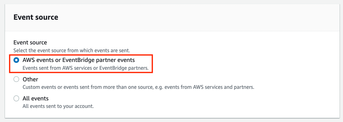

select AWS event source as AWS events or EventBridge partner events

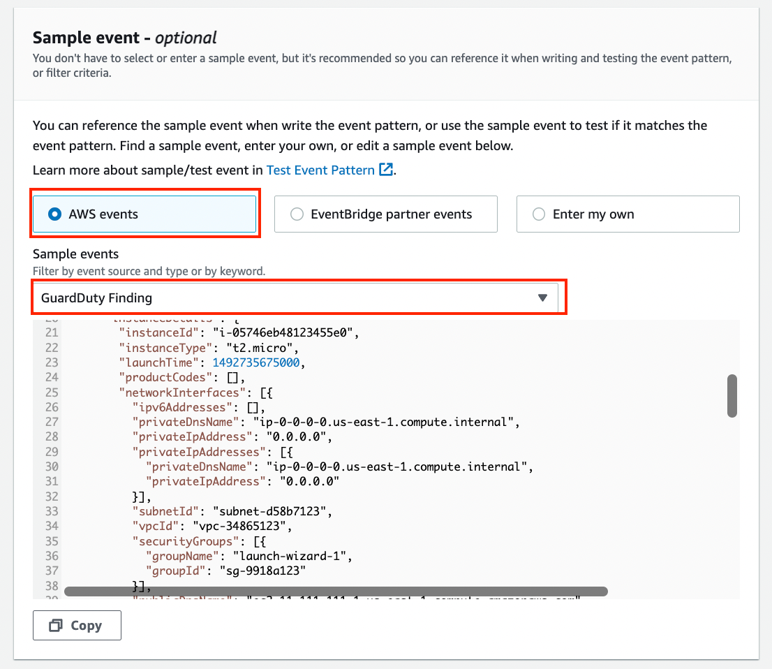

Selection of AWS event in sample event

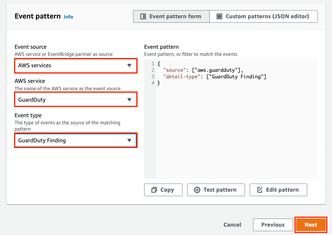

  1. On the next page, perform the following:
  • Event source: Select AWS events or EventBridge partner events
  • Sample event (optional): If you would like to view sample events, you may do so in this section
  • Event Source: Select AWS services
  • AWS Service: Select GuardDuty
  • Event type: Select GuardDuty Finding
  • Click Next to continue
Event Pattern: Event source: AWS service, AWS service: GuardDuty Event type: GuardDuty finding

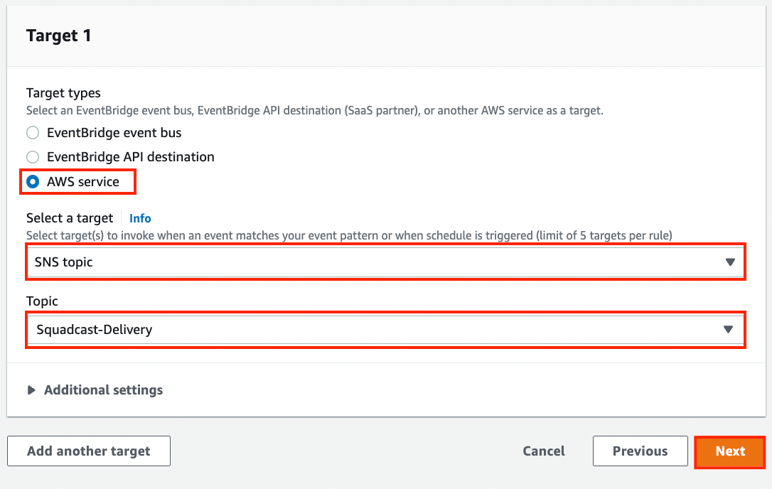

  • Target types: Select AWS service
  • Select a target: Search and select SNS topic
  • Topic: Search and select the topic created in previous steps
  • Configure other additional settings to your preference
Selection of Target type: AWS service, target: SNS topic, Topic: Squadcast delivery to complete guardDuty integration
