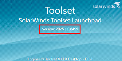

Determine your current version number
Each tool in ETS for the Desktop has its own version number. Do not look at the version number for an individual tool to determine the ETS for the Desktop version number. Use either the Toolset Launch Pad or the Workspace Studio to find the version number:
  • From the Toolset Launch Pad:
    1. Click Help > About Toolset Launch Pad.
    2. Locate the version number just below SolarWinds Toolset Launchpad.
      If a different version number is displayed at the bottom, ignore that number.
  • From the Workspace Studio:
    1. Click Help > About.
    2. Locate the version number just below Workspace Studio.
