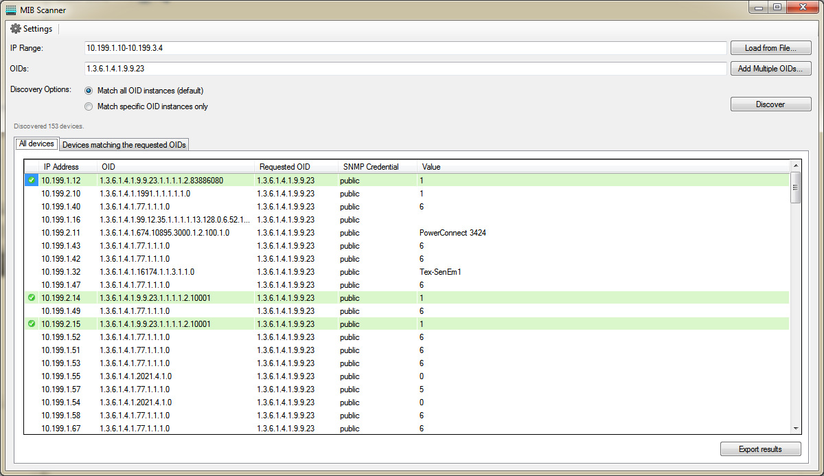

Examples

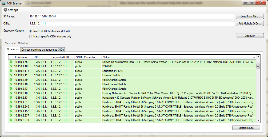

You must scan your corporate network for a set of Windows machines. If you use the sysDescription OID 1.3.6.1.2.1.1.1, and then perform a Discover using MIB Scanner, all the devices on the network that match that OID value are listed in the result pane. You can then sort the results by value and search for matching sysDescription OIDs.
You are going to use the Neighbor Map tool to get a map of your network, but you need to find out which devices support CDP protocol first. You know that the CDP MIB is 1.3.6.1.4.1.9.9.23, and so you enter this in the OIDs field and perform a Discover. The results include several green rows, which represent devices that contain CDP information and might support CDP protocol. The white rows are SNMP devices that did not match the requested OID. Selecting the Devices matching the requested OIDs tab displays a filtered list of only those devices that matched the CDP MIB.
