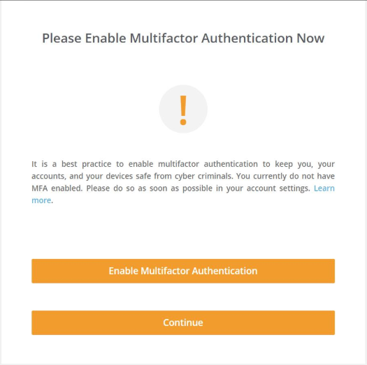

                                    Log in to the End User Area. You will receive a message to enable MFA. Select Enable Multifactor Authentication to activate MFA, or Continue to configure MFA later. You will continue to receive messages after logging into the End User Area to enable MFA.

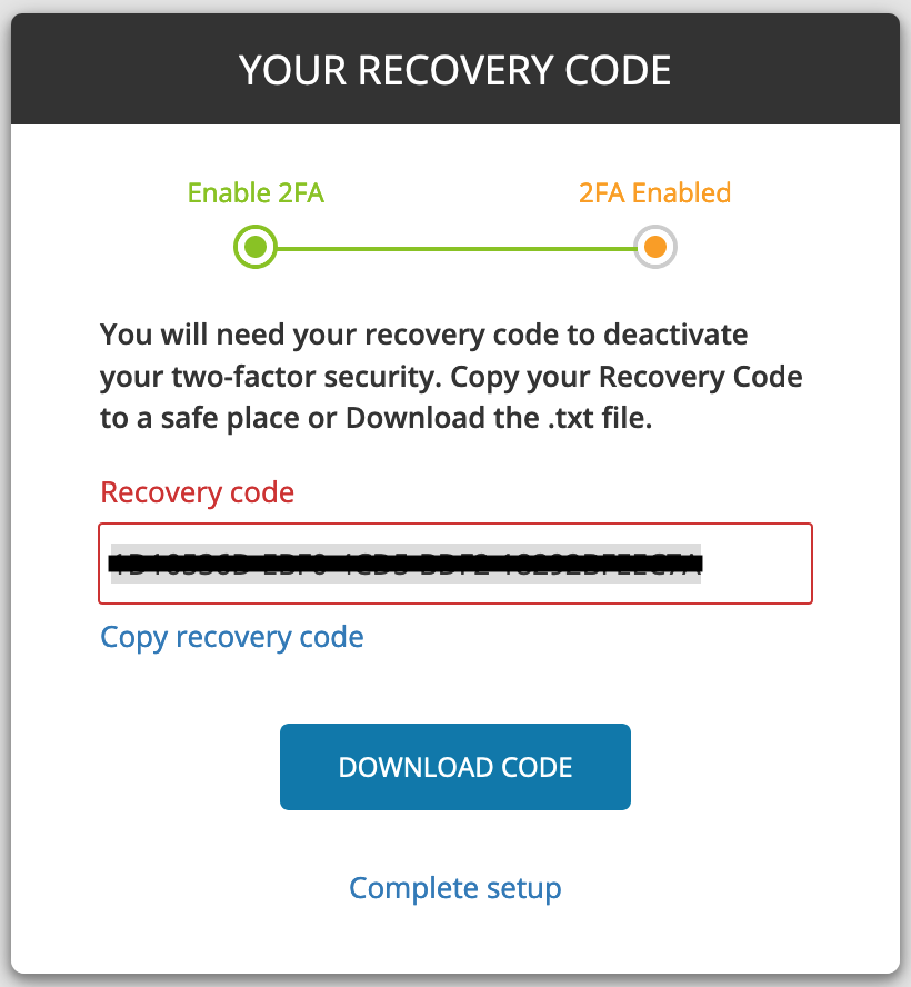

                                    Click Download Code or Copy Recovery Code to save it in a secure location. Click Complete Setup to complete activation of multifactor authentication.
