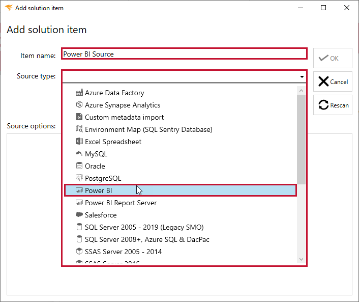

3. Enter an Item name, then select Power BI from the Source type drop-down list.

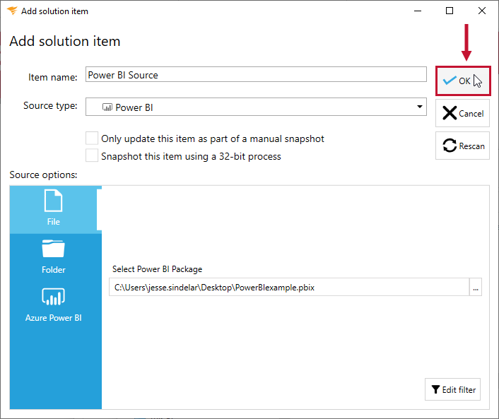

4. Select the Power BI File, Folder, or Azure Power BI.
5. Select OK to add the Power BI solution item to your Database Mapper solution.

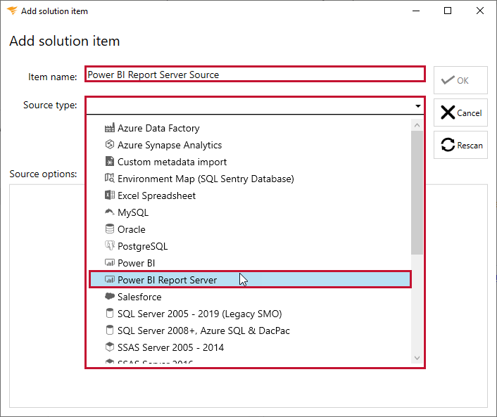

3. Enter an Item name, then select Power BI Report Server from the Source type drop-down list.

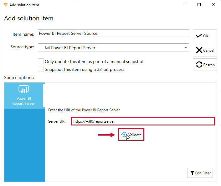

4. Enter the Power BI Report Server URI in the Server URI box, then select Validate to verify the connection.

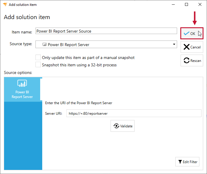

5. Select OK to add the Power BI solution item to your Database Mapper Solution.
