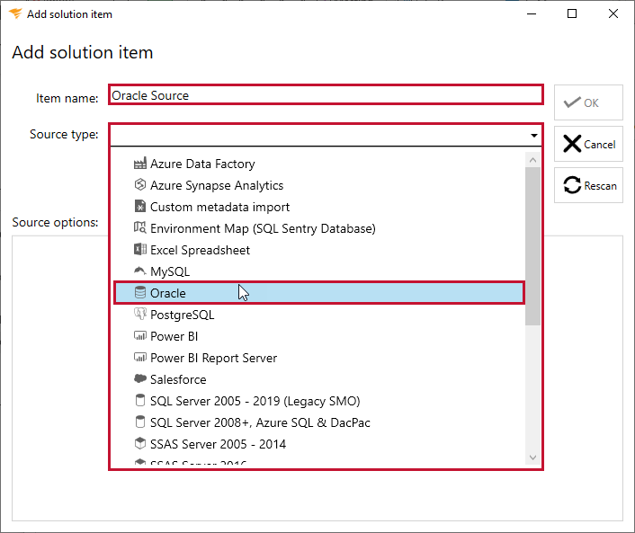

3. Enter an item name, then select Oracle from the Source type drop-down list.
Database Mapper Add Solution Item Oracle

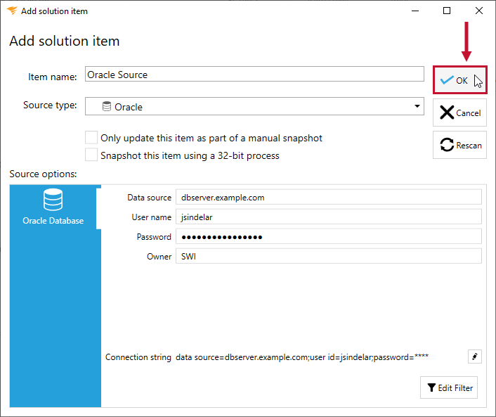

4. Select Oracle then enter a valid connection string. You can either copy and paste a connection string into the Configuration Tool or edit the individual values.
5. Select OK to add the Oracle solution item to your Database Mapper solution.
Database Mapper Add Solution Item Oracle select Ok

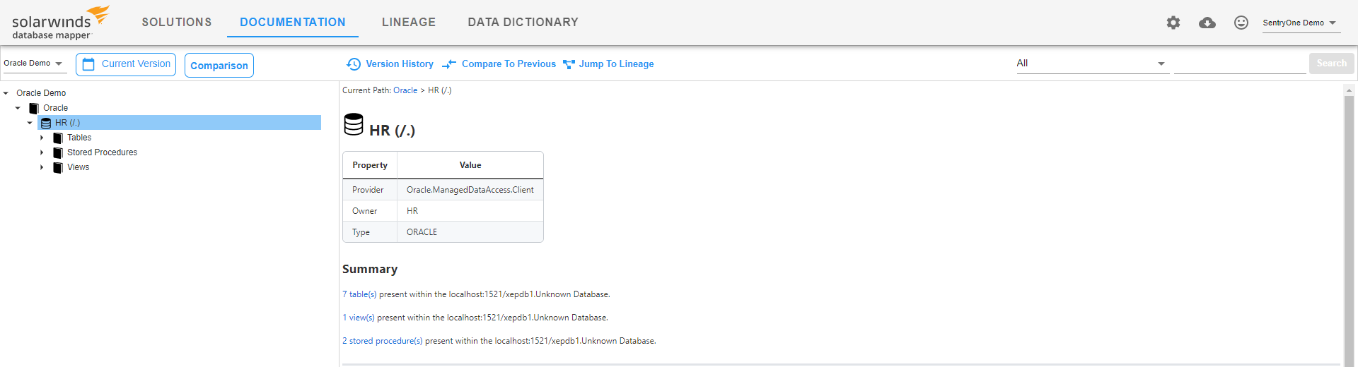

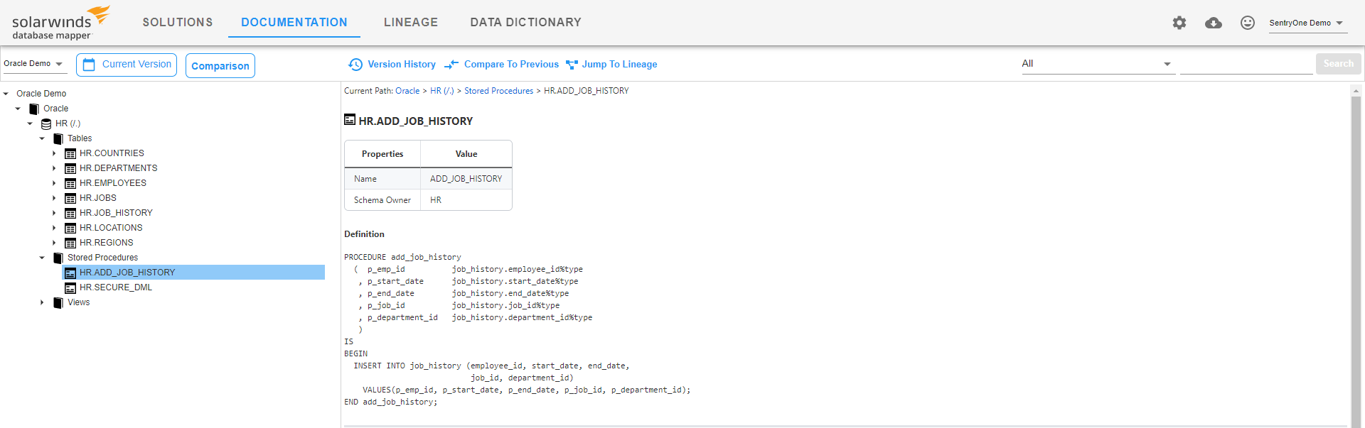

After adding a solution with your Oracle solution item, and taking a snapshot, you are ready to view your documentation.
Database Mapper Documentation Oracle database exampleOracle Database example
Database Mapper Documentation Oracle stored procedure exampleOracle Stored Procedure example
