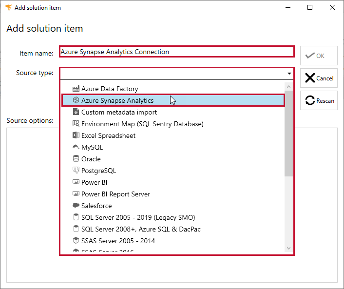

2. Select Add to open the Add solution item window.
3. Enter an item name, and then select Azure Synapse Analytics from the Source type drop-down list.

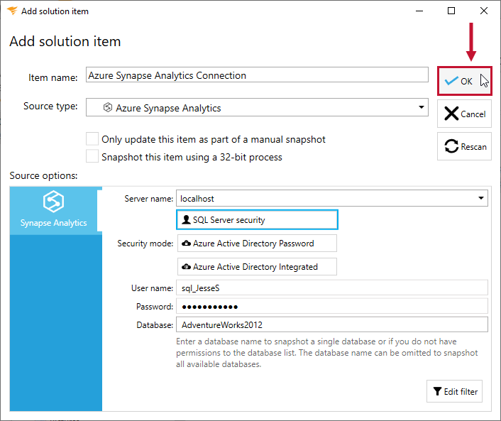

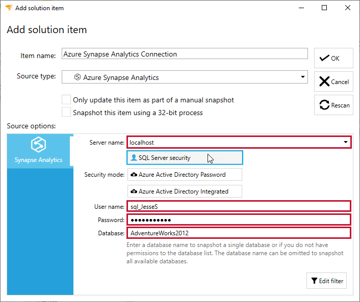

4. Enter your Azure Synapse Analytics server name, enter the credentials for your connection, and then select your connection database.
5. Select OK to add the Azure Synapse Analytics Solution Item to your Database Mapper solution.
