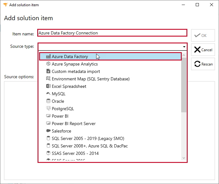

3. Enter an item name, then select Azure Data Factory from the Source type drop-down list.

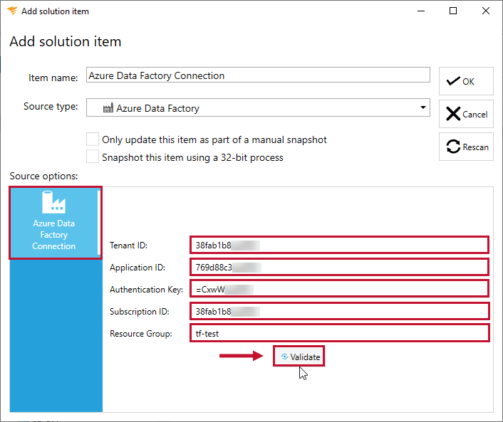

4. Enter the Azure Connection details for your Azure Data Factory connection (Tenant ID, Application ID, Authentication Key, Subscription ID, and Resource Group), then select Validate to verify the connection.

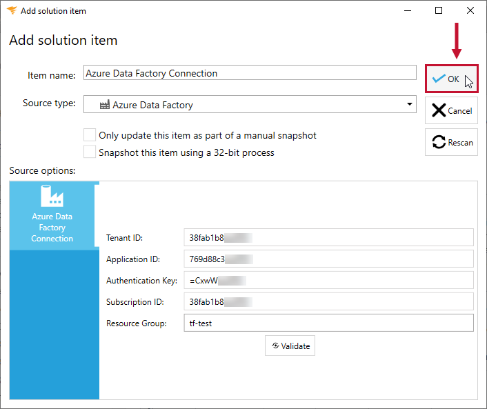

5. Select OK to add the solution item.
