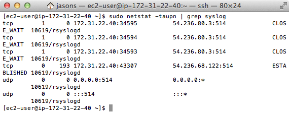

Use netstat to verify Rsyslog has an established connection to Loggly. Specifically, check that Loggly can make a connection through your firewall on the proper port. It’s 514 for syslog, 6514 for TLS syslog, 80 for HTTP, and 643 for HTTPS.
sudo netstat -taupn | grep syslog

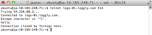

Use telnet to verify we can make an outbound connection to Loggly. For syslog we use port 514. If you can’t connect it might be a network or firewall issue.
telnet logs-01.loggly.com 514

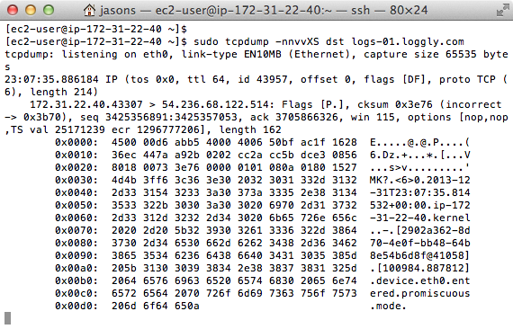

Use tcpdump to verify data is being sent to Loggly. If you send your events in cleartext while tcpdump is running, you should be able to see them in the left hand column.
sudo tcpdump -A dst logs-01.loggly.com
