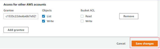

  1. Select the bucket in the buckets panel and click the Permissions tab.
  2. Search for Access control list and click Edit.
  3. Under Access for other AWS accounts, click Add grantee.
  4. In the Grantee field, enter c1533c22deaba6b7e925aac6e1d58eeb7e2d0898e93725dc6f52000b96f48067
  5. Select all the boxes for List/Write objects and Read/Write bucket permissions.
  6. Click Save changes.
AWS provides additional documentation on editing bucket permissions.
