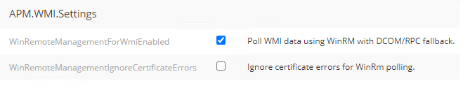

- On the Global tab of the Advanced Configuration page, scroll down to the APM.WMI.Settings section.
Verify that the WinRemoteManagementforWmiEnabled option is selected.
This option is enabled in fresh installations by default. If you decide to disable it, use the SolarWinds Platform Service Manager to stop the SolarWinds Job Engine v2 service, and then restart the service afterward.

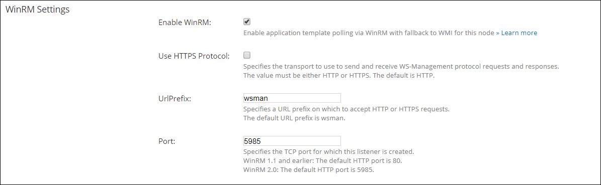

Compare the WinRM URL prefix settings with Node settings on the Manage Nodes page. Navigate to the Manage Nodes page, click Edit Node, and scroll down to the WinRM Settings section.

- Navigate to the Manage Nodes page, click Edit Node, and scroll down to the WinRM Settings section to review settings.

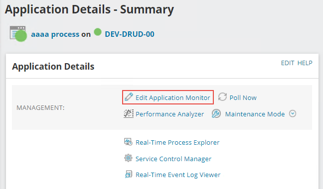

Navigate to the Application Details -Summary page and click Edit Application Monitor.

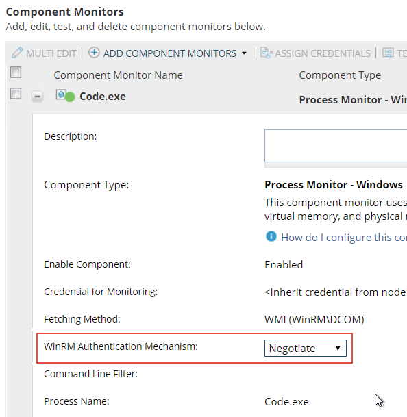

- On the application monitor page, scroll down to the Component Monitor section and expand details.
Review the WinRM Authentication Mechanism setting:
