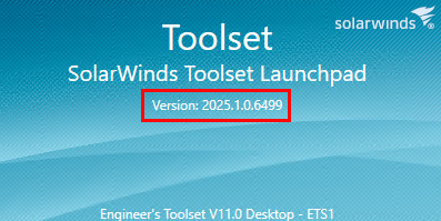

  • From the Toolset Launch Pad:
    1. Click Help > About Toolset Launch Pad.
    2. Locate the version number just below SolarWinds Toolset Launchpad.
      If a different version number is displayed at the bottom, ignore that number.
