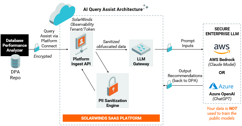

How does AI Query Assist work?
Users with admin privileges can select a query with an explain plan to send for optimization recommendations (as described in the following sections). Platform Connect is used to send the query and plan to SolarWinds Observability SaaS, where they are sanitized to mask any potential personally identifiable information (PPI). The sanitized data is then sent to a secure enterprise LLM, which returns suggestions for optimizing the query. Any user with read privileges can review the recommendations.

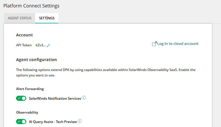

Enable AI Query Assist in DPA
If Platform Connect is not configured
If DPA is not yet connected to SolarWinds Observability SaaS through Platform Connect:
  1. See Connect DPA to SolarWinds Observability SaaS with Platform Connect to configure the connection.
    After the connection is configured, the Platform Connect Settings page opens.
  2. Click the AI Query Assist - Tech Preview toggle to enable AI Query Assist.
If Platform Connect is configured
If DPA is already connected to SolarWinds Observability SaaS through Platform Connect:
  1. Log in to DPA as an administrator.
  2. From the DPA menu in the upper-right corner, click Options.
  3. Under Administration > Configuration, click Platform Connect.
    The Manage Platform Connect Service page opens.
  4. Click the AI Query Assist - Tech Preview toggle to enable AI Query Assist.

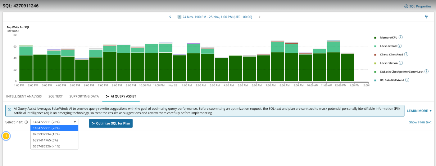

Request an AI optimization suggestion
  2. Do one of the following:
  3. From the Select Plan drop-down menu, click a plan to select it.
    The drop-down menu lists the plans that were available during the selected time period. If a different plan was used in a more recent time period, DPA displays a message. Change the time period to select a current plan. Sending an older plan could result in invalid optimization suggestions. For example, the older plan might not use an index that is now available.
  4. Click Optimize SQL for Plan.
    A confirmation message is displayed.
  5. Click Done to close the message.
  6. When the optimization suggestions are returned, click View Optimization.
    Review any optimization suggestion carefully before implementing it.

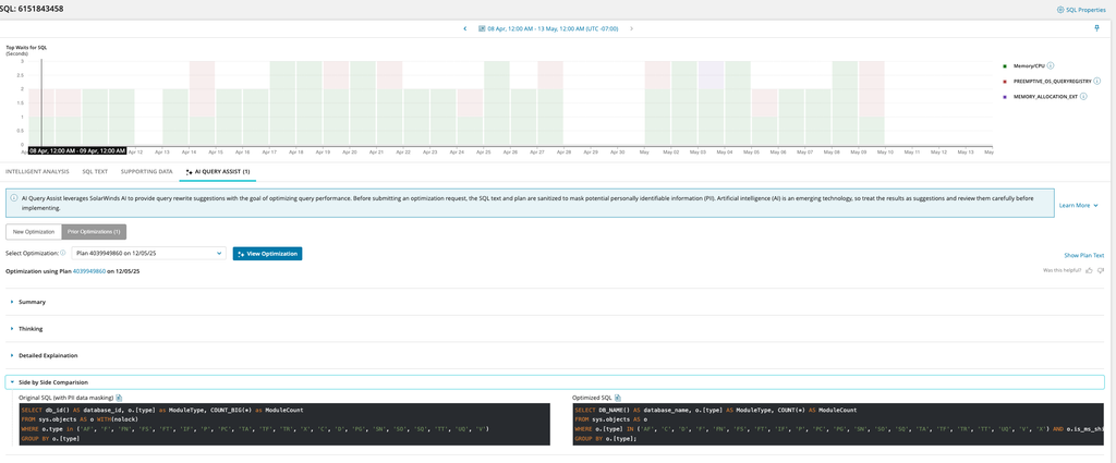

View any existing optimization suggestions
Users with or without administrator privileges can view existing optimization suggestions.
  1. Do one of the following:
  2. From the Select Optimization drop-down menu, click the plan and optimization date that you want to see.
  3. Click View Optimization.
    The results of the optimization request are displayed.
Send feedback
To indicate whether an optimization was useful, click an icon next to Was this helpful?
